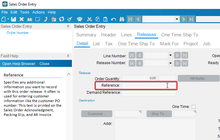

Additionally, on the order release, there’s another Reference field. Field Help says:
Specifies any additional information you want to record with this order release. It often is used for entering customer information like the customer PO number. This text is printed on the Sales Order Acknowledgment, Packing Slip and AR Invoice.
We’d like to use these Reference fields, but we don’t use EDI and are concerned it will break EDI if we misused these fields and decide to use EDI later.
Is it safe to put the customer’s release number in this Reference field on the sales order release, or are we setting ourselves up for issues later on?
