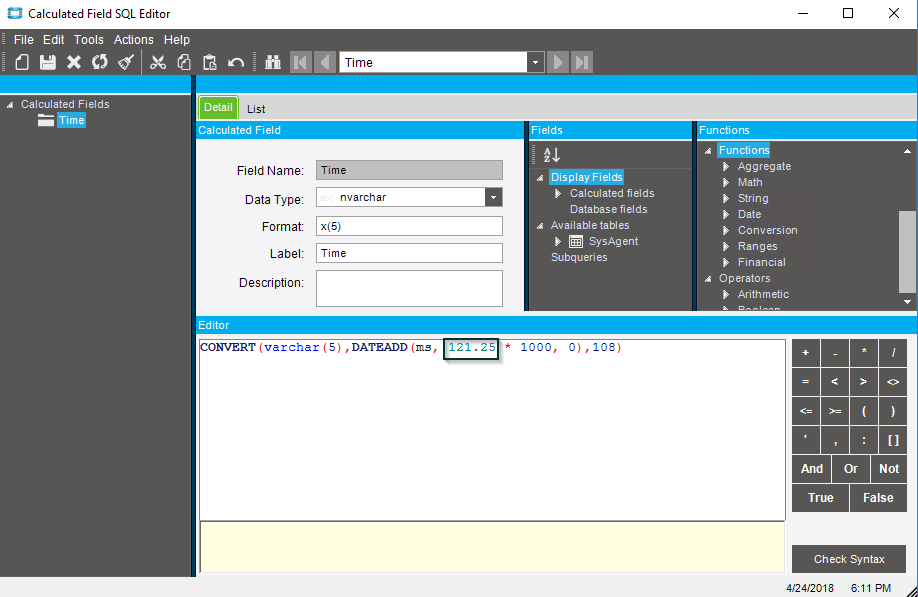

Here is one way to do it - just replace time (121.25) with field that contains seconds
