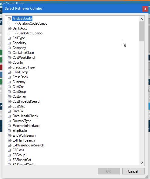

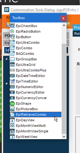

You didn’t specify whether you are doing a classic or kinetic customization. I classic, you can click on epiRetrieverCombo, and when you go to place the control, you get a whole list of retrievers. Is that what you’re looking for?

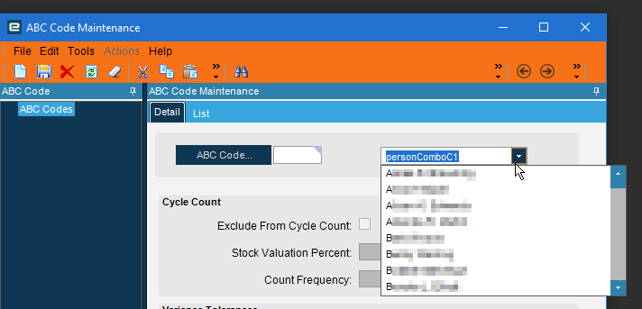

Here’s the personCombo from the list. I didn’t do anything but drop it on there and specify which combo I wanted.
