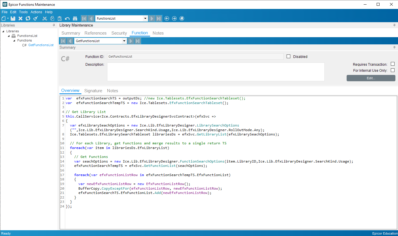

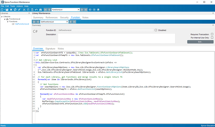

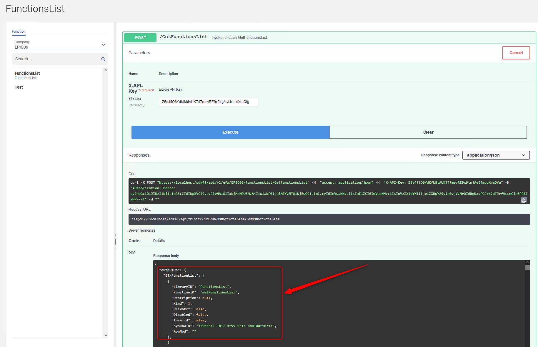

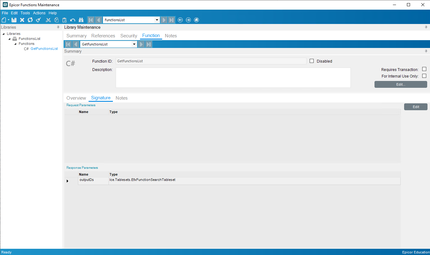

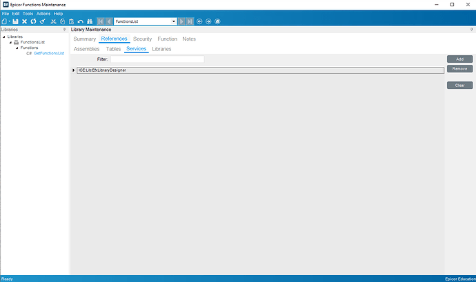

Just as an alternative to @Mark_Wonsil’s valid solution and as an FYI: Below is an example of an Epicor Function to return a list of Epicor Functions that can be used as a starting point.
By leveraging an Epicor Function to return a consolidated list of Functions, it will generally allow a far simpler integration in terms of external code/logic and be far more performant/efficient due to a lot less overhead while also making the broader solution easier to troubleshoot/support/update in the case of potential standard API/service changes in future updates.
var efxFunctionSearchTS = outputDs; //new Ice.Tablesets.EfxFunctionSearchTableset();
var efxFunctionSearchTempTS = new Ice.Tablesets.EfxFunctionSearchTableset();
// Get Library List
this.CallService<Ice.Contracts.EfxLibraryDesignerSvcContract>(efxSvc =>
var efxLibrarySeachOptions = new Ice.Lib.EfxLibraryDesigner.LibrarySearchOptions(“”,Ice.Lib.EfxLibraryDesigner.SearchKind.Usage,Ice.Lib.EfxLibraryDesigner.RollOutMode.Any);
Ice.Tablesets.EfxLibrarySearchTableset librariesDs = efxSvc.GetLibraryList(efxLibrarySeachOptions);
// For each Library, get Functions and merge results to a single return TS
foreach(var item in librariesDs.EfxLibraryList)
// Get Functions
var seachOptions = new Ice.Lib.EfxLibraryDesigner.FunctionSearchOptions(item.LibraryID,Ice.Lib.EfxLibraryDesigner.SearchKind.Usage);
efxFunctionSearchTempTS = efxSvc.GetFunctionList(seachOptions);
foreach(var efxFunctionListRow in efxFunctionSearchTempTS.EfxFunctionList)
  var newEfxFunctionListRow = new EfxFunctionListRow();
  BufferCopy.CopyExceptFor(efxFunctionListRow, newEfxFunctionListRow);
  efxFunctionSearchTS.EfxFunctionList.Add(newEfxFunctionListRow);
