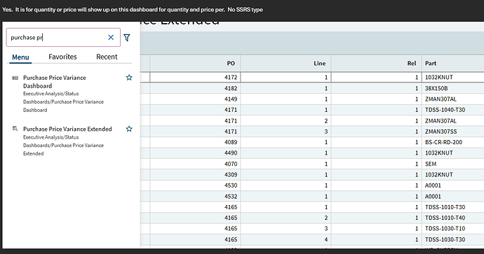

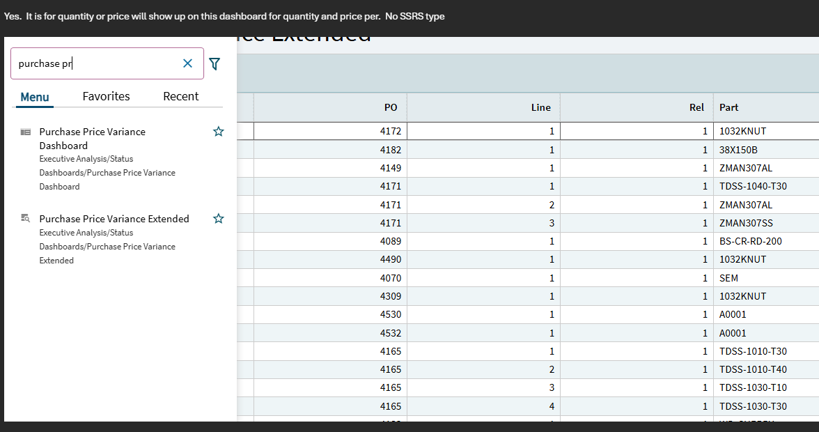

Here’s the screenshot my CAM forwarded to me from one of their solutions engineers:
It only took three weeks and continued harassment… but, yeah. And then, of course, what he finally sent me was worthless, and now we have a call scheduled with one of the higher ups at Epicor on Friday.

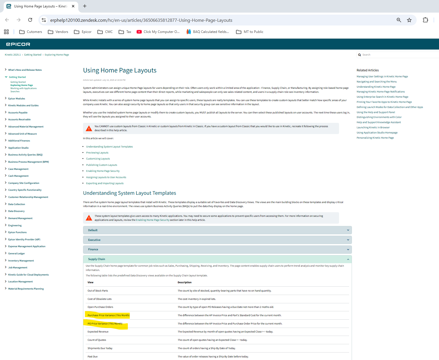

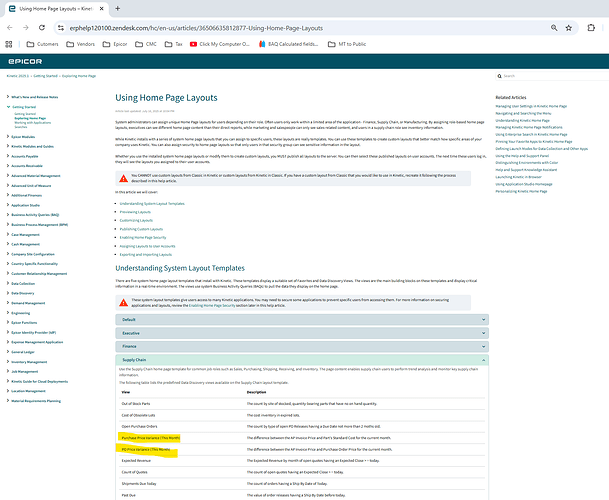

We did not have those either, but did find a reference to it in Help, it appears under the “Using Home Page Layouts”, looks like it is a Data Discovery View. Further down in that page it references the BAQs that feed those. We track ours by G/L code and review the Edit Reports as we enter payables, since we are actively catching/reconciling as we go, most of ours are just penny write-offs.
