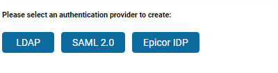

Epicor ECM allows the following authentication provider.
I questioned to the consultant about LDAP and SAML 2.0. He said using SAML 2.0 is more secure. I cannot remember his exact words, but he did not recommend to use LDAP. For us, we only have those 2 options because we are on-prem. We cannot use Epicor IDP.
Ah, yes. LDAP is not as secure.
