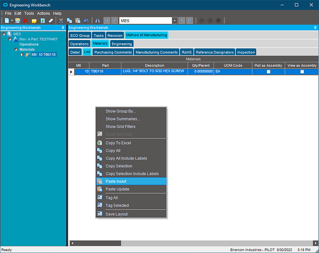

You can go into the list view after adding the first part and right click and paste insert or paste update.
Keep in mind that when you are paste inserting (new lines) or paste update (update the current lines) the columns need to match.

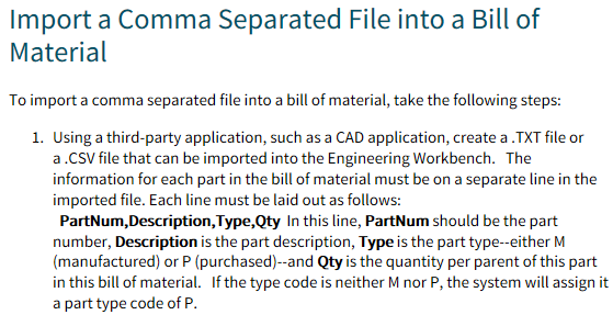

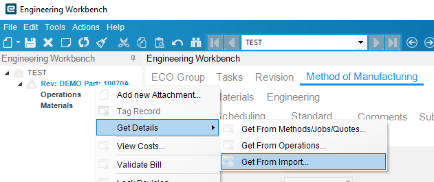

In Engineering Workbench, you can load a csv file to a revision.
The file layout:
If the part does not exist, Kinetic will add it. You will have to fill in other details later.

Creating a CSV for a BOM that contain all the part numbers you want in Epicor.
Import that CSV in EWB BOM and the BASIC part masters should be created at the same time.
