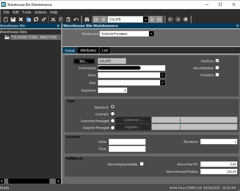

Is there a way to delete a bin, if all transactions have been undone
I made this bin for one of my users so they could receive product form a PO. Problem is i Typo’d the bin number should have been CLOSTE. They undid the transaction of the receipt and the Bin currently has no product in it.
Is there anyway to delete it or do i just need to mark it as inactive and live with my embarrassment?

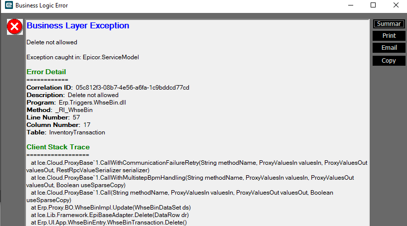

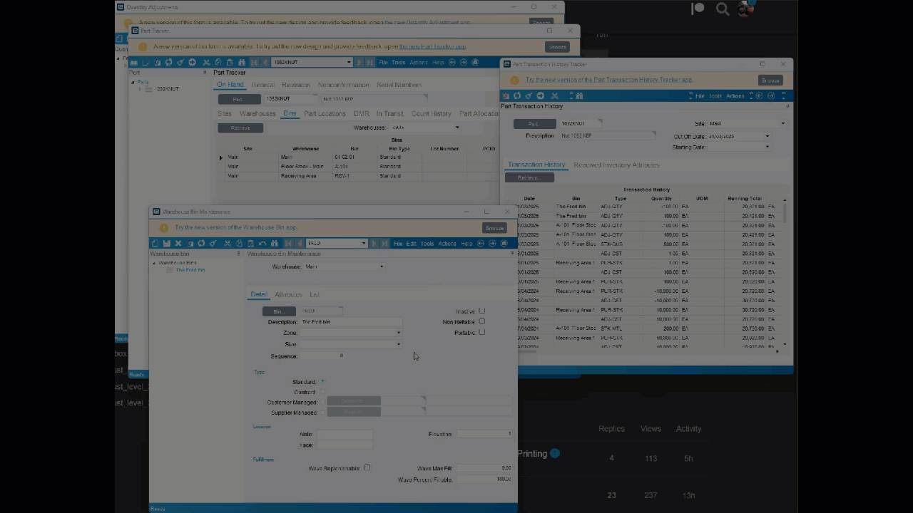

Here is a test. 2024.2 I created a new bin, transacted against it, added 100 subtracted 100, then tried to delete the bin.
Bin Deletion with Transaction data
Result, “Deletion Not Allowed”
If you have not transacted against the bin it should delete, that being said it You won’t be able to delete it if it is setup as a primary bin on any parts. You will get the same error message.
