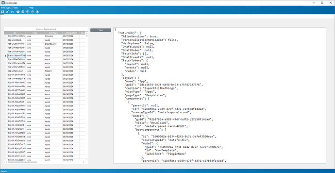

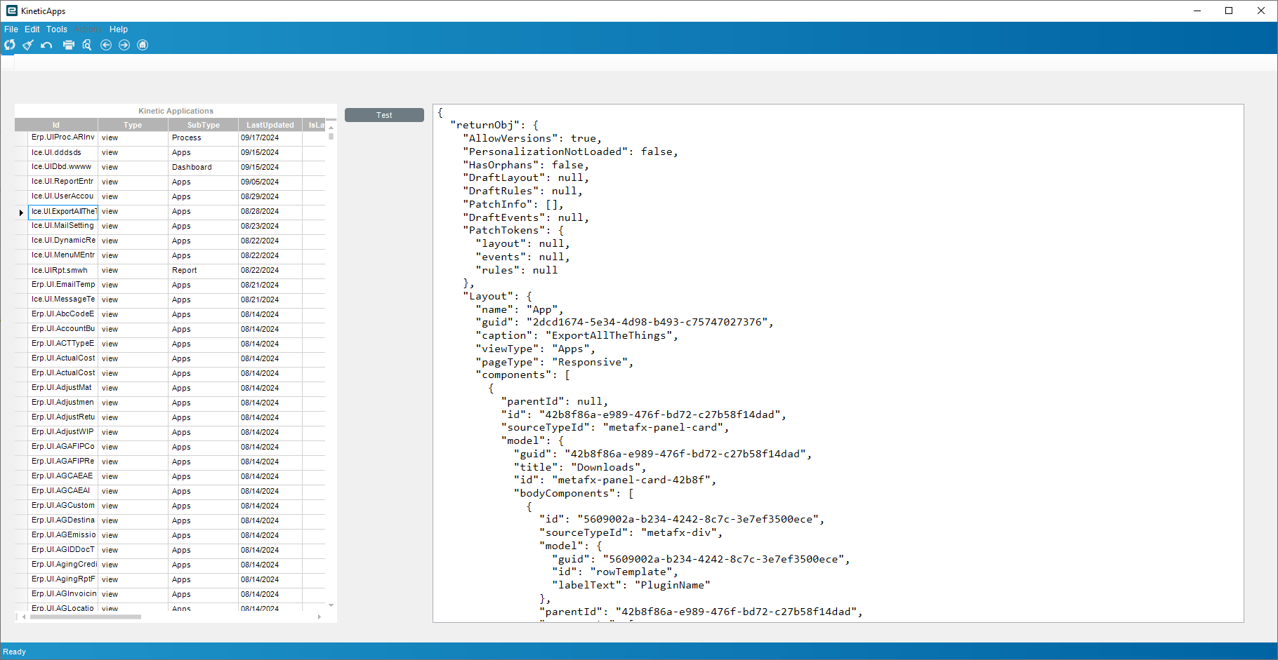

Theoretically, like any other Business Object, just follow the trace that Application Studio uses and it should work.
If that looks helpful, I’ll package it up and share it.
