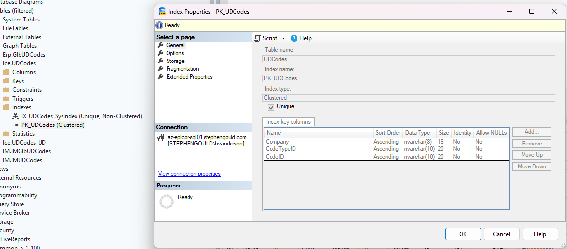

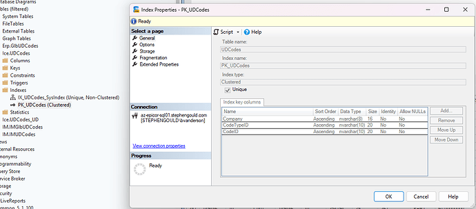

Why don’t you think that would help @aosemwengie1 ? Primary key is Company, CodeTypeID, CodeID. Without the company it’s going to scan the whole UD Codes table for every join. With the company, it will seek.
Obviously it did help . . . but I have major issues joining to UDcodes even with company specified. Once you have tens of thousands of rows in there its a problem because the code types and code ids aren’t indexed.
They are indexed. I just showed you the index. What do you mean they aren’t indexed?

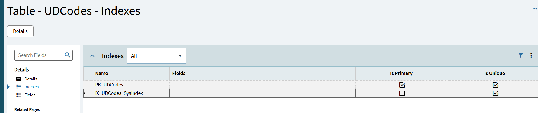

Why is the fields column blank in the data dictionary? That is what is making me think they aren’t indexed since I don’t have access to the database itself.
I am expecting it to look like this one, for comparison:
