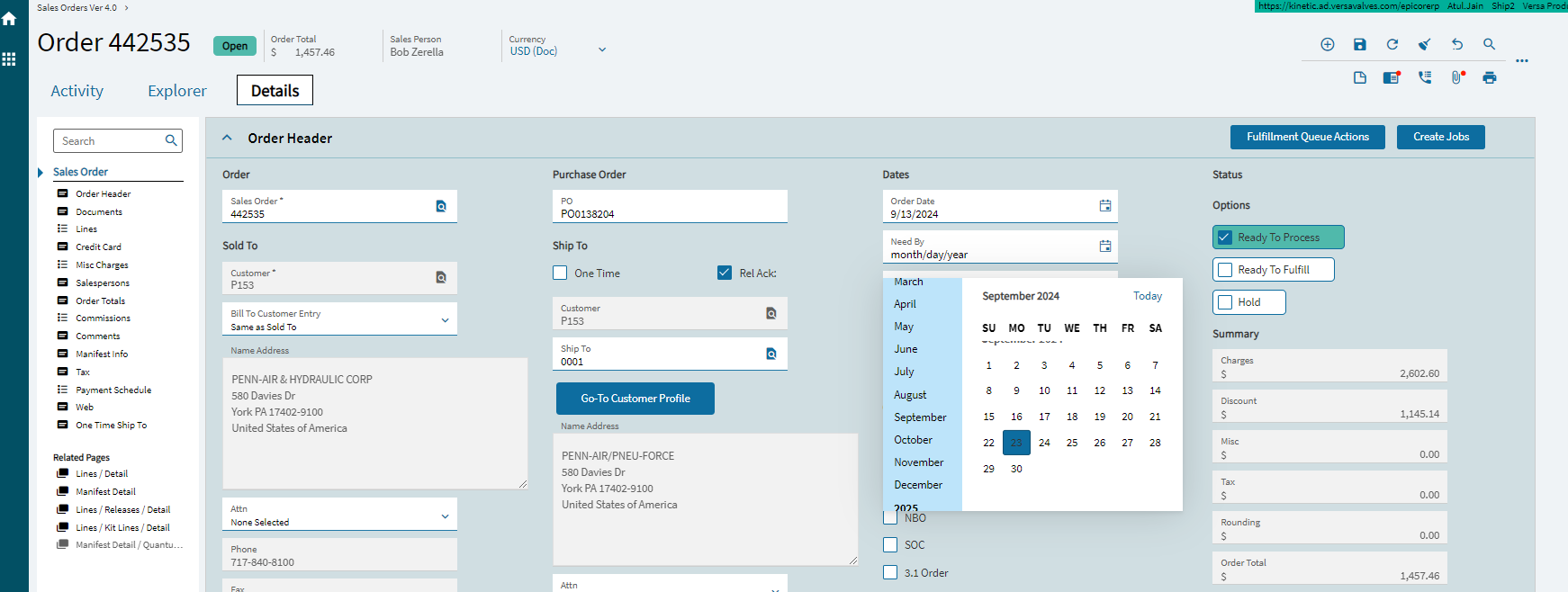

Is there a way to grey out dates based on a production calendar?

As with @dcamlin, I don’t think you can grey out the calendar widget.
One thing I did a LONG time ago was write a BPM that compared the date to the Prod Calendar and pop an error if it was a non-work day.
