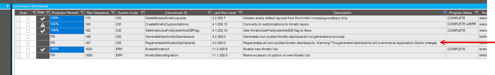

Run conversion 196/197

That sounds scary - From what point does it regenerate and ignoring what layer of App Studio changes?
That is a good question @MikeGross. I haven’t tried it, as its described it looks like ti will replace the entire Base Layer of the Dashboard (which should be fine assuming you made your changes in a separate layer of your own)… But I haven’t tested it
I just tested and it looks like you’re right. My custom layers are still intact after running the conversion.
