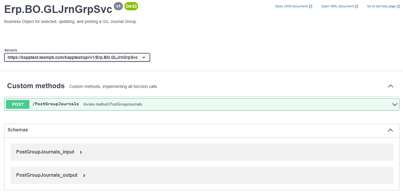

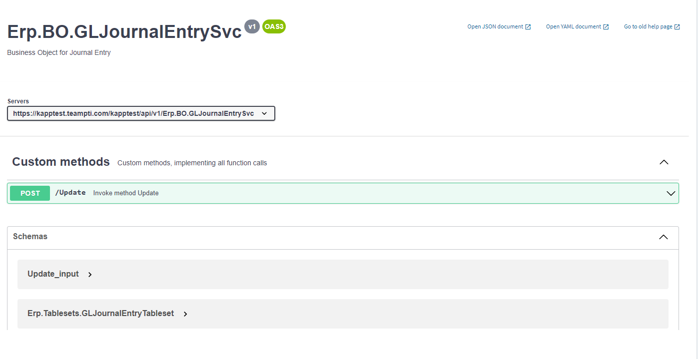

Correct. I’m expecting to see something like this in the trace. This object should create the journal:

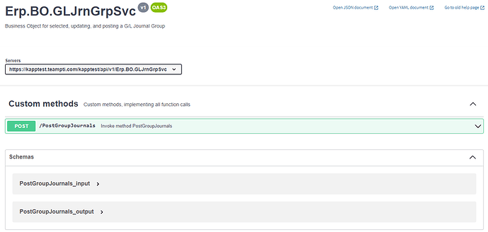

And this one should post the journal:
