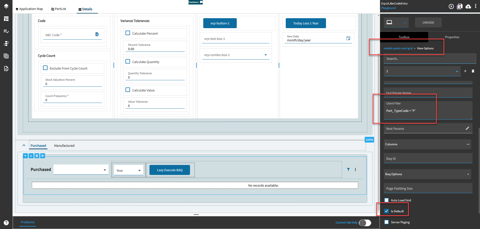

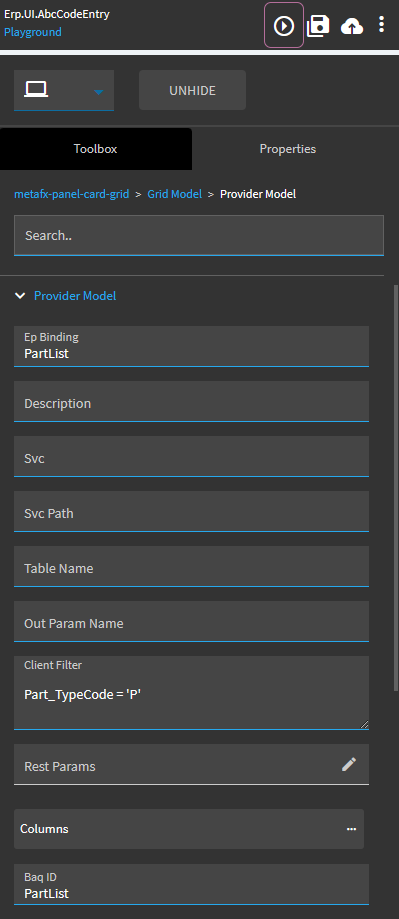

What you should be doing, instead, is you can set them to run via the provider model and set the epBinding to your view, but you should be setting up views under Properties > Advanced to filter the data on the client side for each grid.
This will allow you to maintain a singular dataset, but show filtered data per view.
Actually, you can set that all up in the provider model as well.
Point is, don’t use the where clause; use the client filter.
Thanks! That works perfectly.
Now I guess I have to wire up the refresh events to refresh both the data view and the affected grids or the client filters won’t affect the data.
