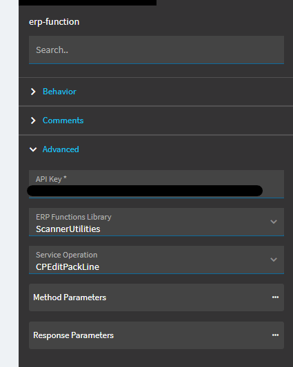

I don’t have to do this yet, but i am dreading it. I have been programming a new Dashboard/program inside of App Studio for the past few months and it uses Functions. As such i am required to enter my API key inside of every Function object.
Now i have Multiple (probably close to a Dozen) of these function calls. When i move my app from my Test environment to my Live environment my understanding is ill need to generate a new API Key and then manually replace the Key on each and every Function call.

API Keys are no longer needed in App Studio. Unfortunately the * remains which makes it unclear.
But remove the API key and retest. You will find that it is not needed.
See the below.

The weird thing is i tried this months ago when i started the project and it didn’t work. I wonder what i did wrong back then thanks.

I tried * for the API Key when running an erp-function in a Kinetic client customization and get error:
: Invalid API Key *.\r\nCompany
We are on Kinetic 2023.2 and I am wondering if 2023.2 required API Keys?

Don’t put * in the field, just leave it blank, though I am not sure if 2023.2 still required them or not but by 2024.1 you leave the field blank.
