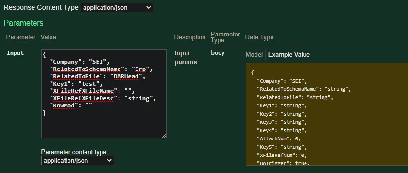

I am using the exact same data in both the Epicor REST Swagger UI, but when I run the POST request through Python or PowerShell it gives me the same error.
Inside the Epicor REST Swagger UI, I am making this POST request:
This posts fine and adds the information.

I can replicate this error in the the Swagger REST UI by putting an incorrect value into one of the fields, and the error I get is this:
Response Body:
"odata.error": {
"code": "",
"message": {
"lang": "en-US",
"value": "The request is invalid."
"innererror": {
"message": "entity : An error has occurred.\r\n",
"type": "",
"stacktrace": ""
Response Code:
400
Response Headers:
"content-length": "221",
"content-type": "application/json; charset=utf-8",
"dataserviceversion": "3.0",
"date": "Tue, 09 Mar 2021 18:12:39 GMT",
"server": "Microsoft-IIS/10.0",
"x-powered-by": "ASP.NET"
I replicate this error in the UI by placing a string value into a Boolean value instead, where it was expecting ‘true’ or ‘false’ I passed ‘asdf’ and it throws this error.
However in my code I am not passing any improper values, and can pass the exact same parameters I am using in the code in the Swagger UI, and it works.
