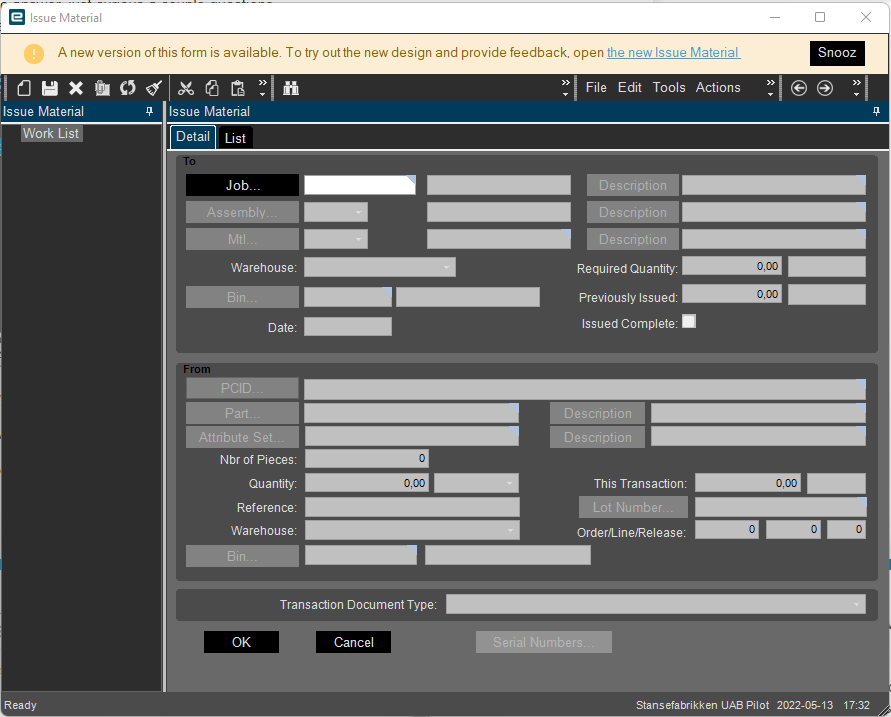

We are facing some strange thing with issue complete function. The question is maybe anyone else saw this and found any reason, becouse epicor support did not helped much on this.
So we have baq which shows the difference on required to be issued and issued actual. In many cases on stamping operation we need to flag lines as issue complete with a big difference on required and issued, so we mark this as issue complete, but the strange this that like after 1 day some of these lines remains again as not flaged as complete and baq retrieves them again. We do use back flush for all operations except on stamping. When user flags it as issue complete, after this no one logs on this operation so there are no more labors for this operation. So has anyone faced the same?

Field help text. "Select this check box to indicate that this material issue completes the requirements for the job material sequence. If the issue quantity to-date is less than the planned requirement, selecting this check box will free any remaining allocation for the part.
This check box defaults to selected if the quantity entered plus any previous quantity issued exceeds the estimated material or assembly pull quantity. Clear the check box if this material issue does not complete the requirements for the job material sequence."
