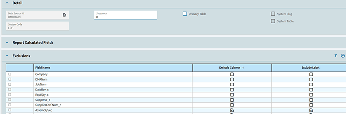

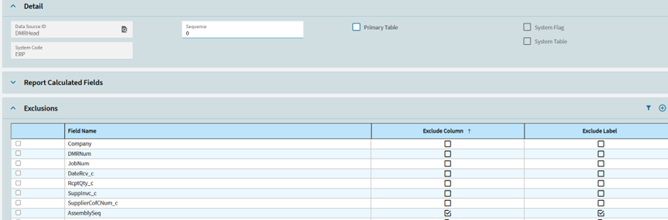

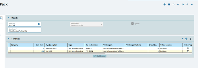

Create duplication of MscShip data definition, rename to TTE_DMR2. Bring in DMRHead and un-tick fields (exclusions) required for join and main query.

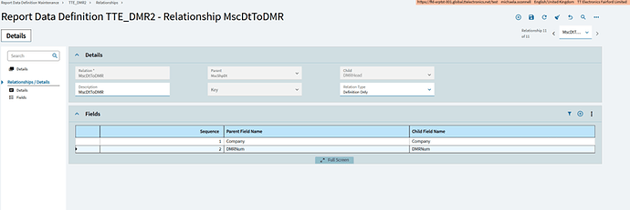

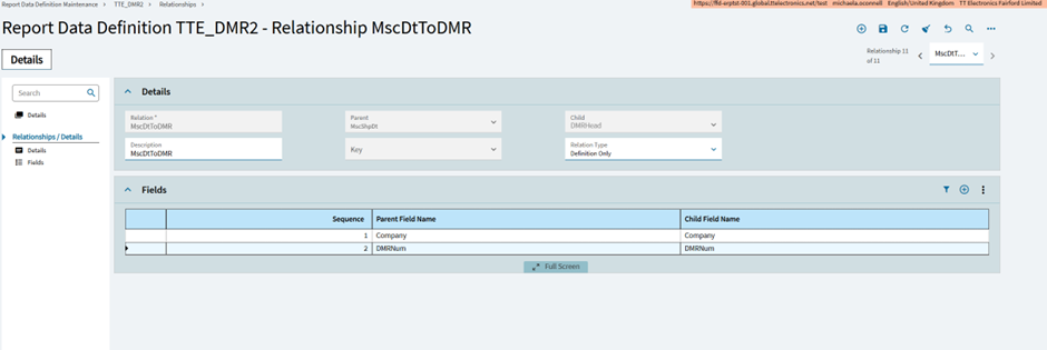

Create new relationship MscDtToDMR
Map new data definition within the report style

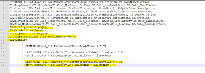

Update dataset query to include left out join to DMRHead and new fields

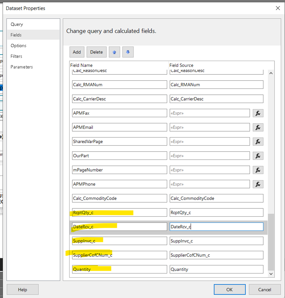

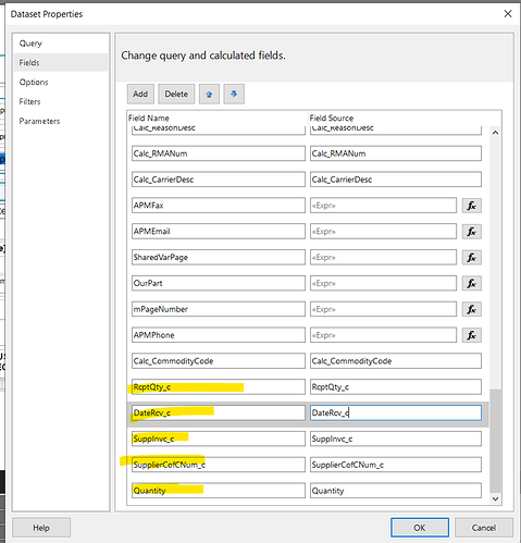

Add fields to the data properties like for like

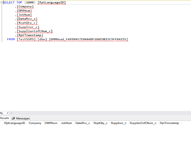

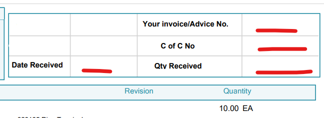

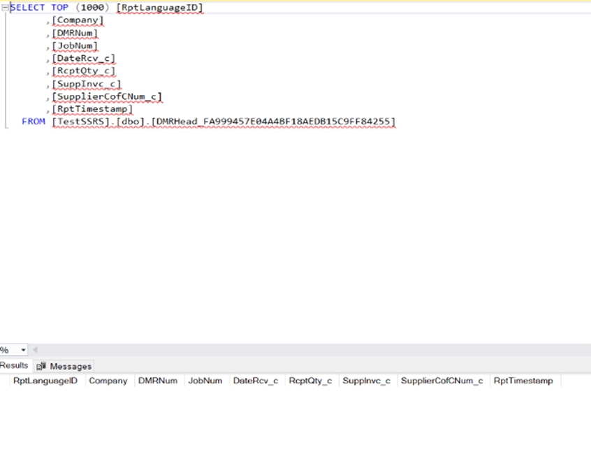

Save all / Test Print and no data from the DMRHead table gets generated. Have checked via BAQ for the DMR number in this example and there is data there, it’s just not appearing on the SSRS report

Change the relation type to Output instead of Definition Only.
Thank you so much Joe!! This worked!! :slight_smile:
