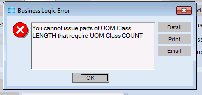

You have to use an active P/N for the place holder, else the job treats it as Purchase Direct (Buy To Job), which will have a blank UOM Class.
Even if the Job specified an On The Fly Part with UOM of FT, and you try to issue a part with UOM of FT, you’ll get:
We ran into that so ended up adding 2 mtl steps, one in EA and one in FT for them to use. Until we come up with a better solution, that seems to work, and also allows us to get a list of those items added so we can look to see if we need to add those to the list of items needed in the future.
