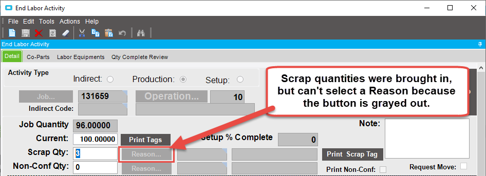

When the End Activity form loads, I have code that brings in labor and scrap quantities from an external production monitoring system if those quantities are available. That works fine. The problem is when scrap quantities are brought in, the scrap Reason button remains grayed out and the user cannot select a scrap reason.
If the user changes the scrap quantity and presses tab then the Reason button becomes active but then the user needs to change the scrap quantity back to the correct value. This defeats the purpose of bringing the quantity in automatically.
I’ve tried setting the ReadOnly and Enabled properties of the scrap reason button but neither seem to work.
I’ve found that if I populate the scrap reason code with a value, the reason button will become active. The user then needs to select the correct reason code but there’s nothing stopping them from just leaving the [wrong] reason code there and clicking OK. This is what I’m doing now with a pop-up message telling them to select the correct reason code but this is not ideal.
Does anyone know how I can get the scrap reason button to become active when a scrap quantity is brought in without populating the reason code with a value?
