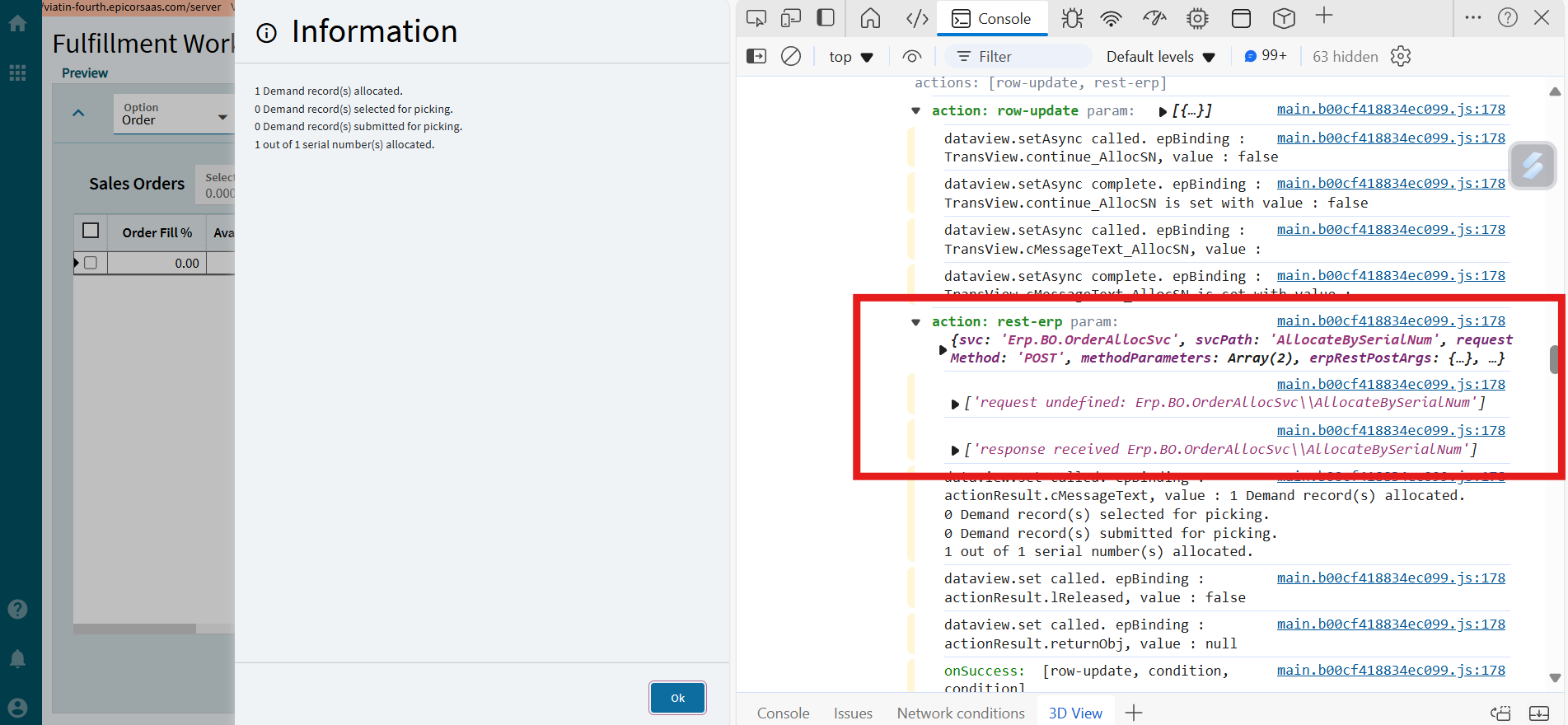

How can I ensure that all the serial numbers selected via auto-selection are properly allocated without requiring manual intervention? Below are the entries for both the cases.
Auto Selection :-
Auto-Selction
As you can see in Info Message only 1 serial number is allocated, inspite of 3 serial number checked in allocation grid.

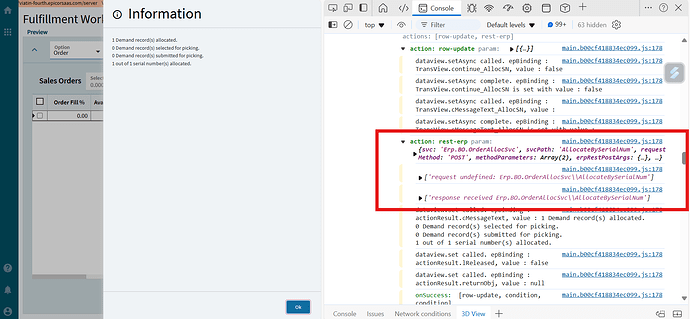

Manual Re-selection :-
AutoSelection + Maual Selection
In this all 3 serial number’s are allocated.

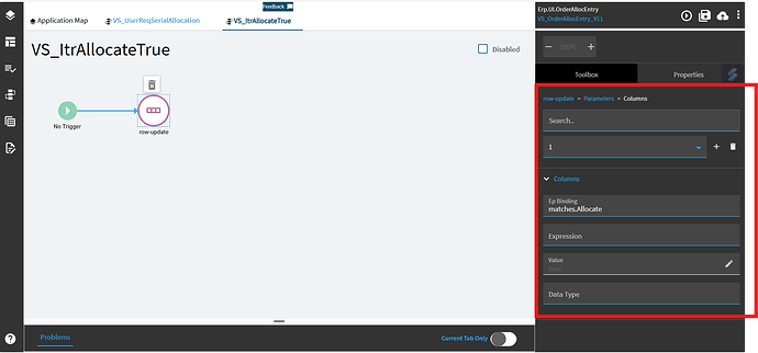

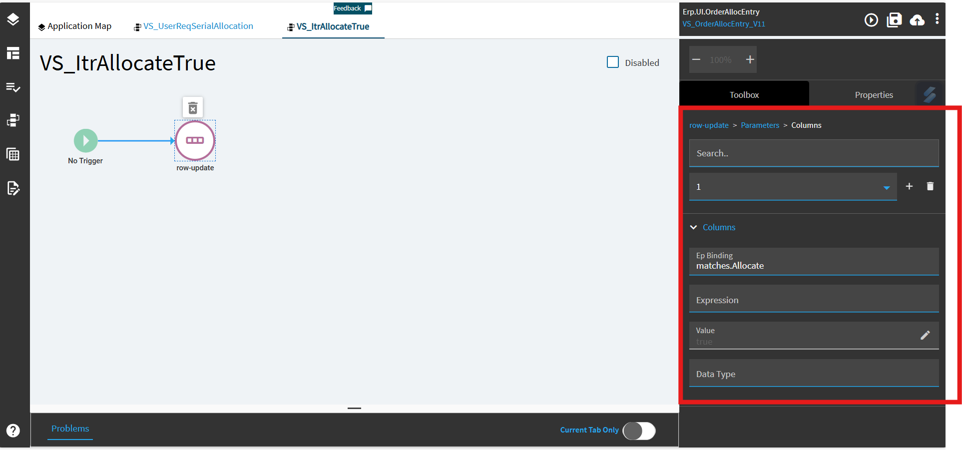

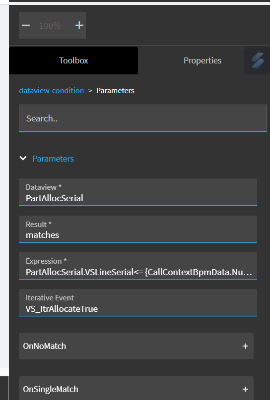

Hello @klincecum,

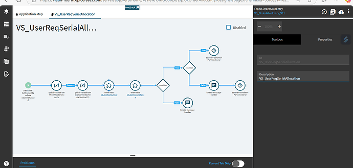

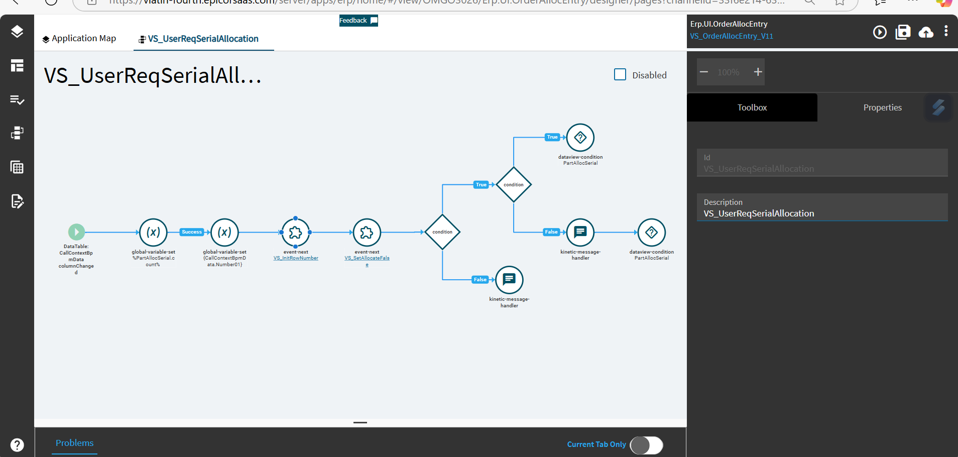

Thank you for your reply. I marked the rows by creating event in Application studio shown below. I have used dataview condition widget to iterate through whole grid while marking only those rows which are entered by user.
Below is the my dataview condition widget configuration
Below is the iterative event

Hello Epiusers,
Does anybody have any idea what is going inside this function shown below.
I have been selecting 3 serial number using event shown in above post but then too this service call only returns 1 serial number allocated. But when I manually select the check box it returns 3 serial number.

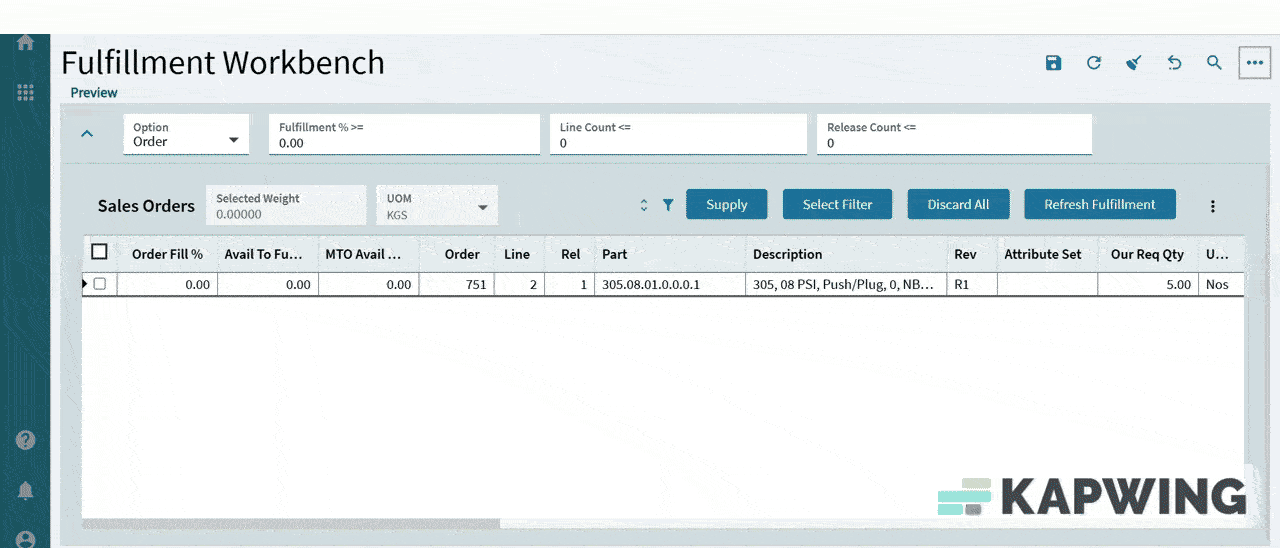

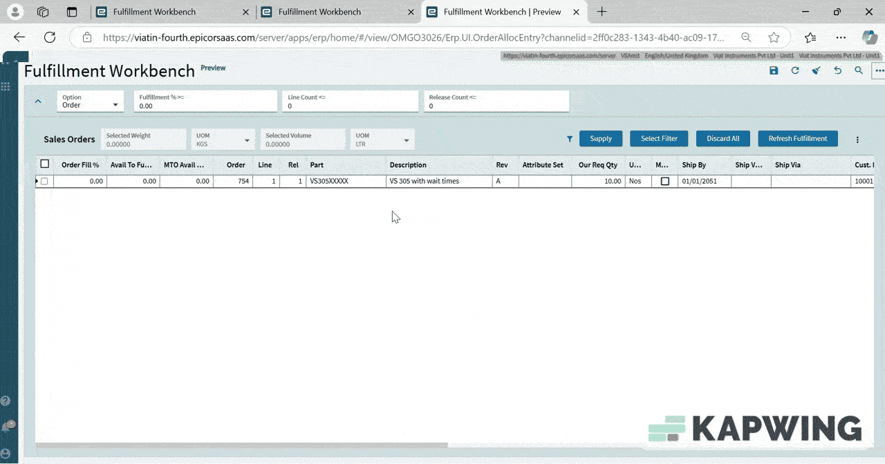

@dcamlin, as you said I have checked the trace log to find any event I’m missing. Surprisingly I found one thing that if I just select the selector column and then select continue, then also I’m able to allocate required serial number.
Recorded_screen_1_V1
I’m a bit confused now, as this behavior seems to be related to grid properties or functionality. It appears that simply selecting rows doesn’t work—activating the grid itself might also be required. However, I’m currently stuck on how to achieve this.
