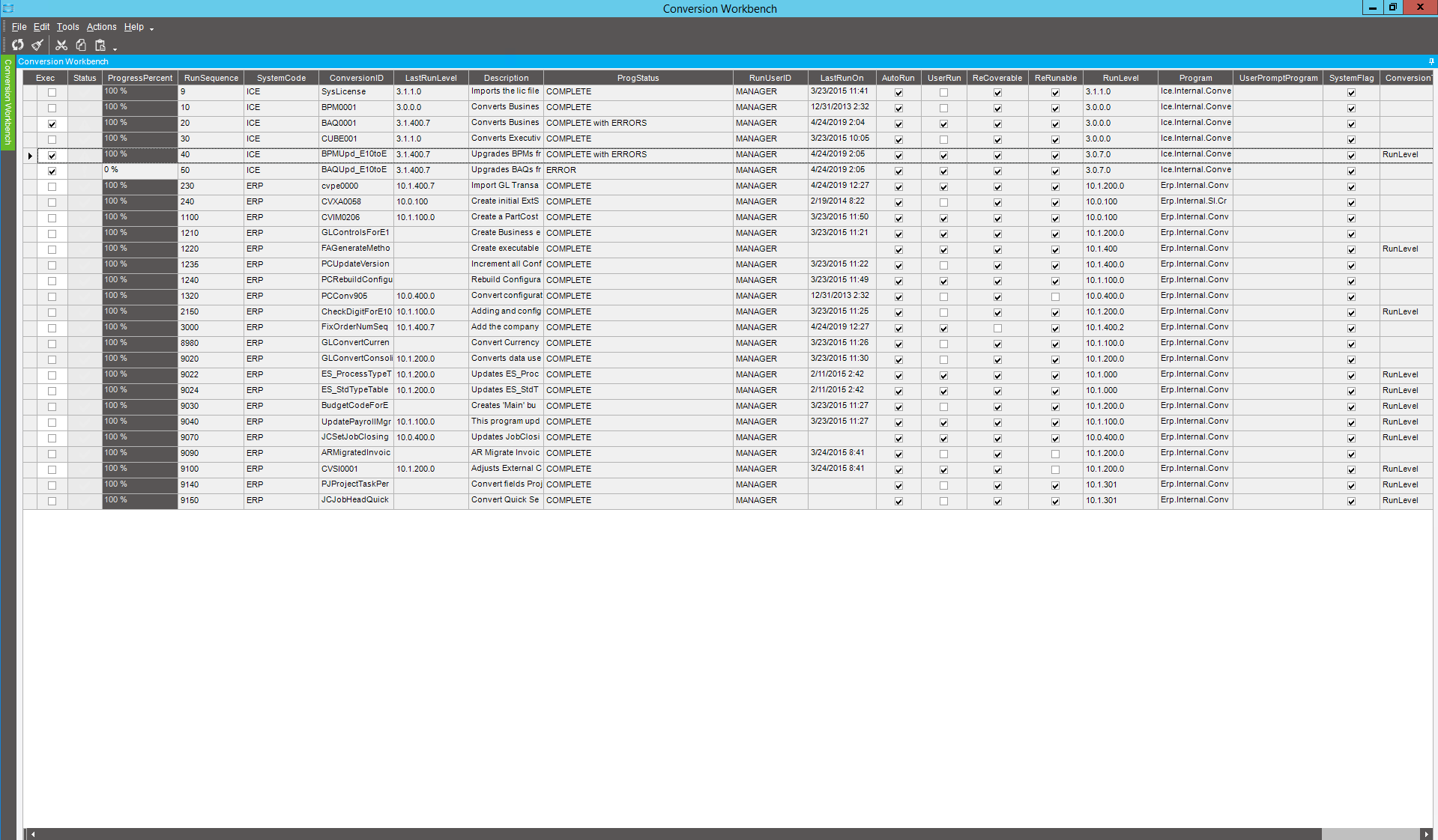

trying to install a demo database for 10.1.400.7. I started with I believe a database on version 10.1.400.0, it asked to run a few conversion programs but I get stuck on the Conversion Workbench at “RunSequence” 50 per the screenshot below. Does anybody have any pointers to a resolution?

Double click on the line, what’s the error?
Darn it, never thought of double-clicking to get details. Weeding through the error details, it seems that the most significant error message is: “4/25/2019 6:02:50 AM : Program Ice.Services.Lib.RunTask raised an unexpected exception with the following message: RunTask: The module BusinessProcessManagement is not licensed or enabled.”
You didn’t install your licenses before running conversion. Install license and try to run again… however some of these may not be recoverable you may have to re-do it.
I noticed my license was not attached to all the companies of the demo database. I attached but still not working. I am going to follow your suggestion: delete the db and re-do
I deleted the db, the application server, added the license to all companies and still get the same error.

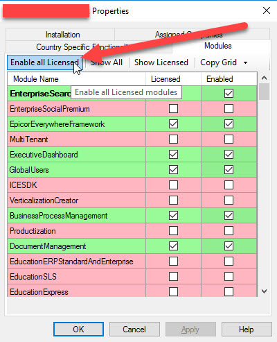

Have you enabled your licences?2019-04-25_12-46-22
That was my issue. Thank you
I added a new Demo DB that was version 10.1.400.0 (the only I got) when my server is 10.1.400.7, that is why it automatically ran upgrade and conversion programs. Thank you for your help, I was able to make lots of progress.
