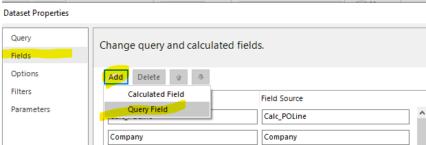

In order to comply with recent changes to export documentation, we now need to insert the HS code (Commodity Code) and Country of Origin onto each line of our Packing Slip. I have followed all the tutorials and help articles that I can find, duplicating the RDD, creating a new report style, adding a relationship to pull in these codes from the Part table but whatever I do, when I edit the form and attempt to add the fields, no data appears. I have added an additional join into the query and and added query fields but without success.
