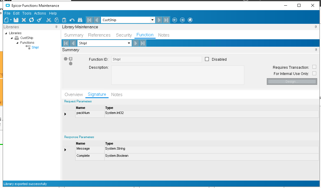

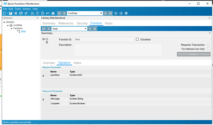

Here’s how the function looks like
And the code it executes
