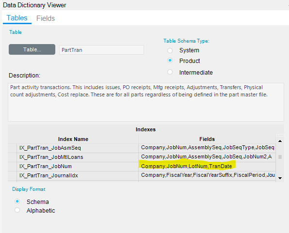

There are quite a few indexes on PartTran. If your query provides the values for the leading keys, the retrieval isn’t an SQL scan in SQL Server terms. Providing Company and JobNum should give you fairly good response.

Thank you for the info about the indexes. So we’ll need to know the tran date to take advantage of the job index? Bummer, because that’s not something I’d be supplying on my report.

No, the index is sorted first by company, then jobbnum, then lotnum then Trandate. If you have the first 3, it can still use the index. Like @Mark_Wonsil said, company and jobnum should get things trimmed down to a fairly small number of rows and then be able to go from there.
