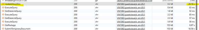

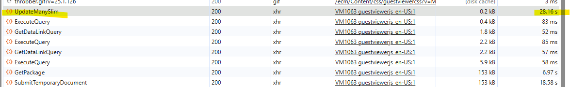

I've been getting problems recently where our production server takes way longer to create documents via public links

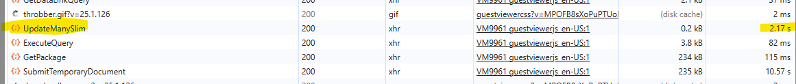

The problem is because the UpdateManySlim API endpoint is way faster in our test environment:
Vs. production:
I have the same form with the same code and the difference is huge. Also, both databases have similar data but are not identical
Anybody has clues as to what can cause this ?

As for the production server, you’re right that there is more stock on there. However, if I compare both dev and production ECM databases, they are pretty similar in term of quantity of rows.
For the number of calls, the Javascript is the same in both. The screenshots cropped the rest of the calls but they are there in DEV. The only call that is different in term of speed really is the UpdateManySlim
Not sure what you mean by ‘running using the client instead of the server’ ?
And the ECM application is installed on its own server and then they are connected to an external SQL server (Which is different for DEV / Production)
The only thing I’m noticing is that in my production, I see one more ‘Custom Field’ being sent and that one doesn’t seem to get all properties (There’s no CustomFieldGroupId for example). I looked at the form / content type and they seems identical
However, I tested another form and then they have the same number of custom fields (30) and the DEV took 1.1 second while the PROD took 14 second for that UpdateManySlim call. So probably not it
