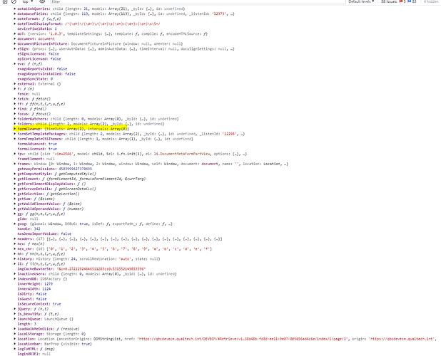

Something like that still isn’t working. The error message says that window.formValidation is undefined. The difference is that if I use the other bit of code that also uses the window object, that one works:
var handle = setTimeout(function() { var val = "test";}, 100);
window.formCleanup.timeOuts.push(handle);
Because if you log the ‘window’ object, you’ll see that the formCleanup is defined yet the formValidation is nowhere to be seen
