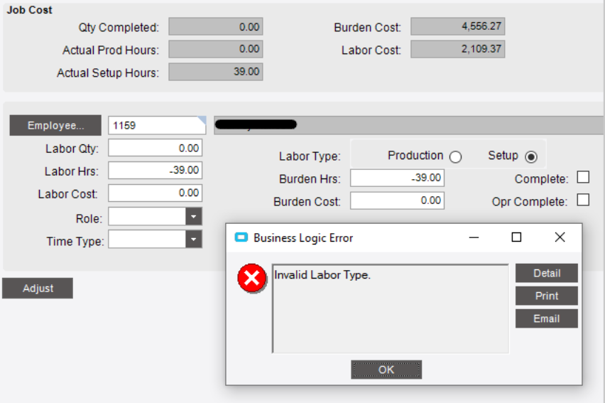

An employee has been charging time to the wrong job so we are trying to move the labor and burden costs to the correct job using Job Adjustments. However, we’re getting an “Invalid Labor Type” error. Does anyone know why it won’t let us adjust the setup hours and how to fix it?

It looks like if the LaborDtl Labor Type is not “P” (Production) AND the JobHead Job Type is “PRJ” (Project) or “SRV” (Service) then it throws this error
Hi Gage, thanks for your response. The JobHed.JobType is “MFG” so it shouldn’t throw the error based on what you said.
Huh. I hoped it would be more open and shut. The decompilation shows:
		if (!ttJALaborDtl.LaborType.Equals("P", StringComparison.OrdinalIgnoreCase) && (jobHeadWithProjectFields.JobType.Equals("PRJ", StringComparison.OrdinalIgnoreCase) || jobHeadWithProjectFields.JobType.Equals("SRV", StringComparison.OrdinalIgnoreCase)))
			throw new BLException(Strings.InvalidLaborType, "LaborDtl", "LaborType");
where that exception is sending the message “Invalid Labor Type.”. Perhaps they have changed logic on it between our versions, I don’t know.

Apologies, I jumped the gun. The fixes didn’t work, but developer support helped and said if the job is tied to a project, then the only labor type that can be adjusted in Job Adjustments is Production. Setup cannot be adjusted. If you remove the project from the job, it will work.
