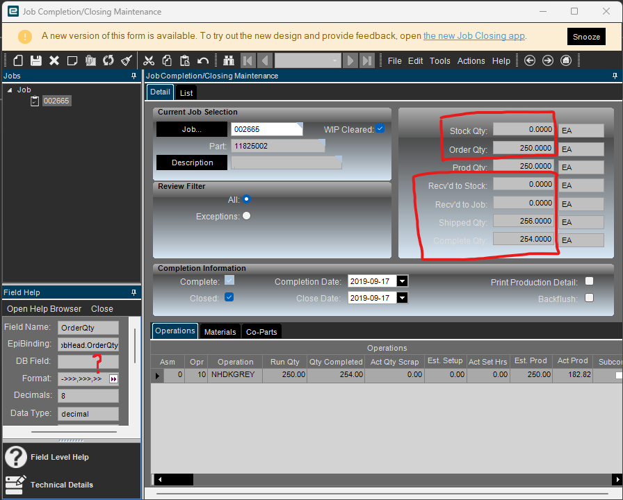

Hello everyone!
I’m fairly new to Epicor, but have been working primarily with BAQs and Dashboards. I am trying to create a BAQ that uses data from the Job Closing (Job Completion/Closing Maintenance) window. Using Field Help I was able to find only “Prod Qty” as Field Help states a valid DB Field. I am also fairly confident that “Stock Qty” is JobPart.StockQty since all of the numbers seem to match.
However, I am not able to find all the matching DB fields for “Order Qty”, “Recv’d to Stock”, “Recv’d to Job”, “Shipped Qty”, and “Complete Qty”.
I realize these fields may be calculated fields as well. However, I am not able to find any information anywhere that talks about the logic of how these are determined or which DB tables/fields they refer to.
I tried to use Tracing options, but as far as I know they don’t display this sort of information…
Does anyone have any tips on how I can determine the logic for these fields? If I knew a technique on how to determine them, it would have help me throughout Epicor, so that would be ideal.
Thank you for your time!

I was able to figure this out. JobProd.ProdQty has multiple entries per JobNum (depending on operations, materials, and co-parts(?)) and therefore has to be summed to get the full ProdQty.
JobProd.ProdQty = StockQty + OrderQty + JobQty where the Quantities on the right aren’t from tables, yet appear the Job Closing Maintenance screen. Each has its own entry in JobProd.ProdQty.
To get the right value for Order Qty, we have to mention that Job Qty also exists and is only present when JobProd.TargetJobNum is populated. Therefore, Prod Qty = Stock Qty + Order Qty + Job Qty.
  • StockQty = JobPart.StockQty - I found that this is always true.
  • OrderQty = JobProd.ProdQty - StockQty - JobQty
  • JobQty = JobProd.ProdQty - StockQty - OrderQty
  • ProdQty = StockQty + OrderQty + JobQty
Note that JobQty is only present when JobProd.TargetJobNum is populated and, if that’s the case, OrderQty will be 0.
For Recv’d to Stock, Recv’d to Job, Shipped Qty, and Complete Qty, I found that Recv’d to Stock and Recv’d to Job are never both greater than zero, one of them is always zero if the other one is not zero.
Therefore:
  • When JobProd.TargetJobNum is populated:
    RecvdToStockQty = 0.0 and RecvdToJobQty = JobPart.ReceivedQty
  • When JobProd.TargetJobNum is not populated:
    RecvdToStockQty = JobPart.ReceivedQty and RecvdToJobQty = 0.0
  • ShippedQty = JobPart.ShippedQty
  • CompleteQty = JobHead.QtyCompleted
This logic has been working out for me and seems to work for every job I checked.
