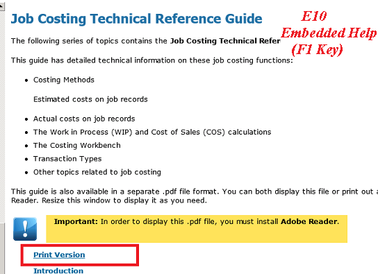

Sorry, I’m not sure from your explanation… and getting an answer to job costing questions can to be a little “involved”
I am just wondering if you have already looked at the “Job Costing Technical Reference Guide”?
I usually start there when I have any questions about labor/burden calculations.
If you don’t already have a copy, you can find a link to the PDF in the E10 embedded help

Can you please suggest where to download this Job costing Technical reference Guide, as I am pretty new to Epicor , Thanks
PDF versions of several Tech Ref Guides are listed in the Epicor Help.
Thank you, Got it
