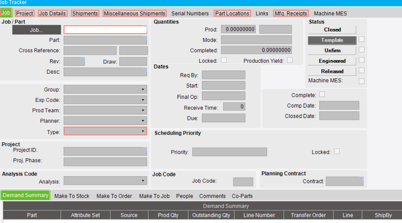

But in my Epicor there is no field to see the job creator. Should I add a field?
@pilio.lee
You would need to add them to JobTracker.

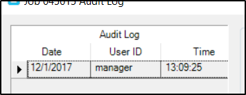

Log in the Job Audit log
Should record the user id of who created and when.

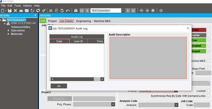

Yes. I also checked the audit log. But no information came out. Doesn’t this field only appear when there is a change?
You probably don’t have the Audit log enabled in company configuration.
Go to;
System Setup / Company Site Maintenance
Open Company configuration
Go to;
Modules / Production / Job Tab
Check these two boxes.
From this point forward the audit log will be created
Thanks for your reply.
I know this setting. But, this is only entered when the Job is modified in Engineered status, I want to know the original creator of the Job.

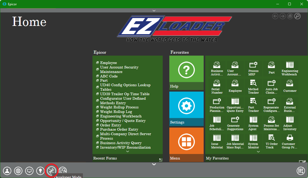

First enter ‘Developer Mode’

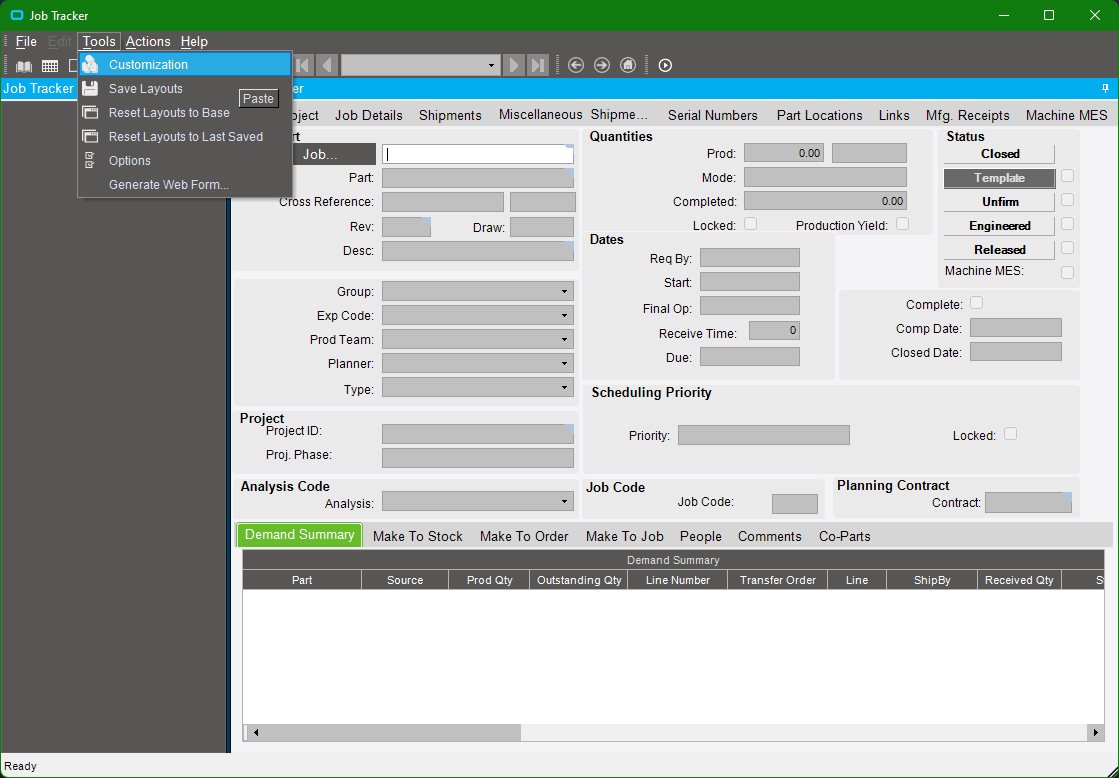

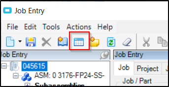

Open Job Entry or Job Tracker select form to customize.

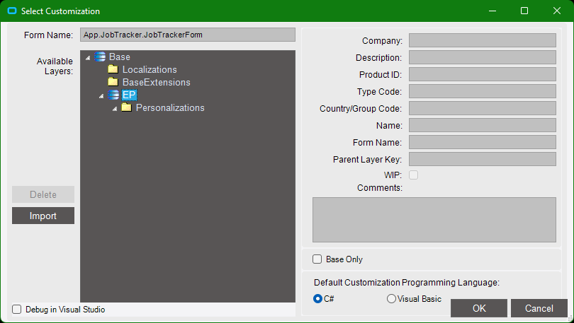

Customize

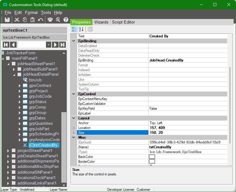

Use the Customization Tools Dialog UI and open the Tools > ToolBox to add a epiTextBox and set the EpiBinding to JobHead.CreatedBy
Save and test if all goes correctly you can set this as default customization in the Menus.
