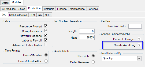

Do you have the create Audit Log box checked in company configuration?

Chris,
The Change Log is different from what Rebekka is referring to.
The recording of the Get Details information automatically generates a Memo, no mater if the Create Audit Log is enabled or not. This functionality happens regardless if the Job is Engineered or not.
The Create Audit Log just forces a user to enter an Audit Log Entry when they change an Engineered Job.
