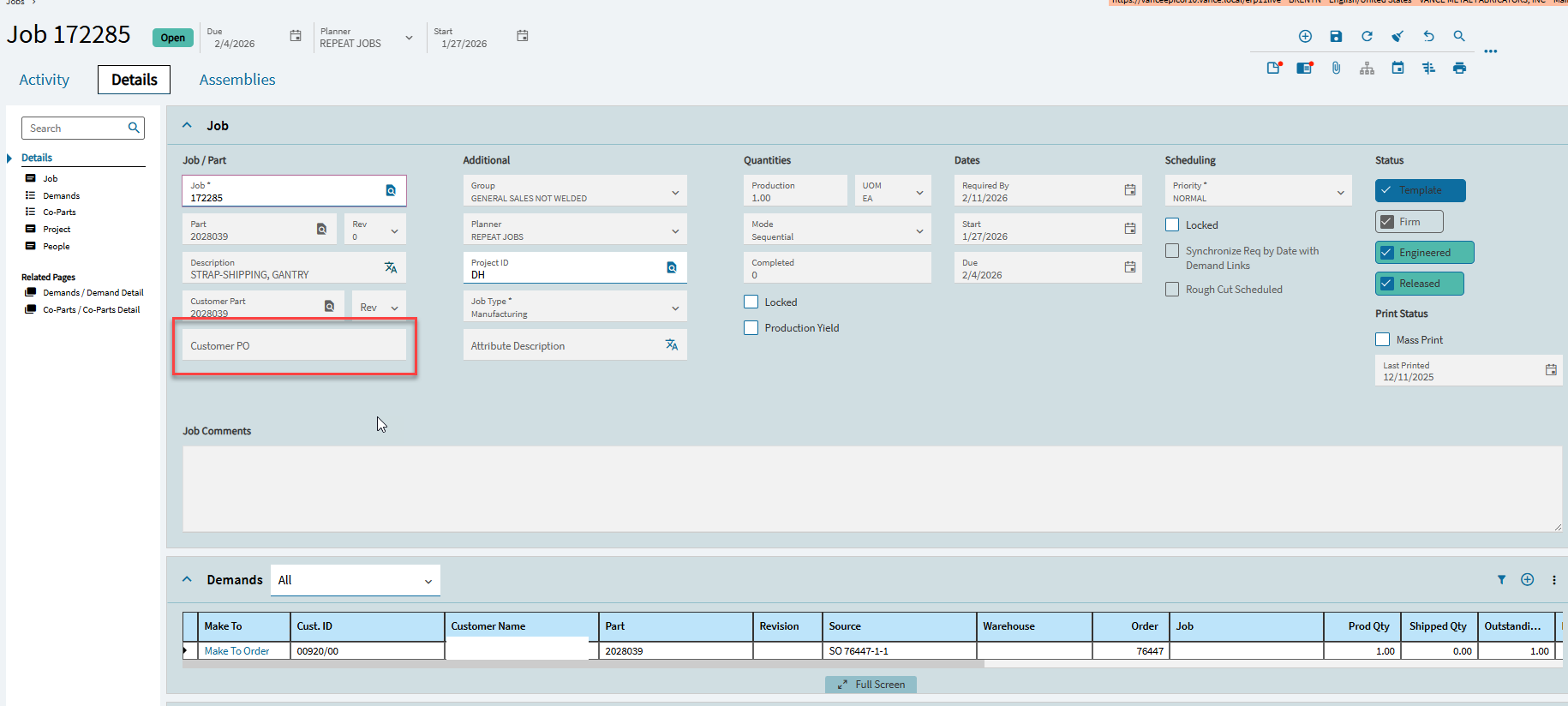

Does anyone know how I can get the customer PO number that is entered in Order Entry to appear in job entry as a reference?

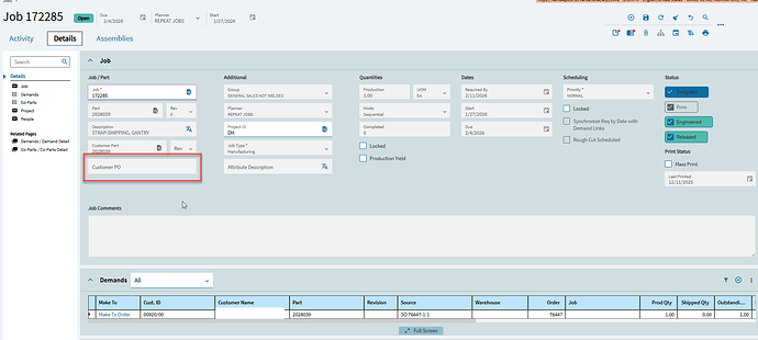

Going this route adds the “CustPONum” column directly to the JobProd dataview. So, no real customization work is needed in Application Studio other than binding your textbox to JobProd.CustPONum.
And/Or, you could add the CustPONum column to the existing “Demand” grid, which is already bound to the JobProd dataview:
