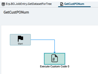

I tested by creating a BPM (Post) on JobEntry.GetDatasetForTree which is the method Job Entry calls which populates the JobProd dataview.
Code (starting with @klincecum’s… massaging for our purpose… and then using AI to improve efficiencies cause Davey-no-Codey):

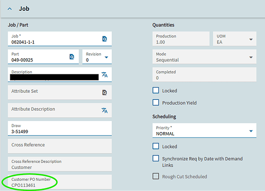

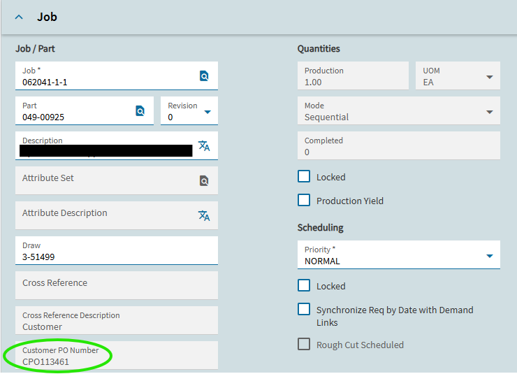

Going this route adds the “CustPONum” column directly to the JobProd dataview. So, no real customization work is needed in Application Studio other than binding your textbox to JobProd.CustPONum.
And/Or, you could add the CustPONum column to the existing “Demand” grid, which is already bound to the JobProd dataview:
