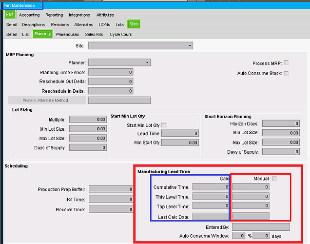

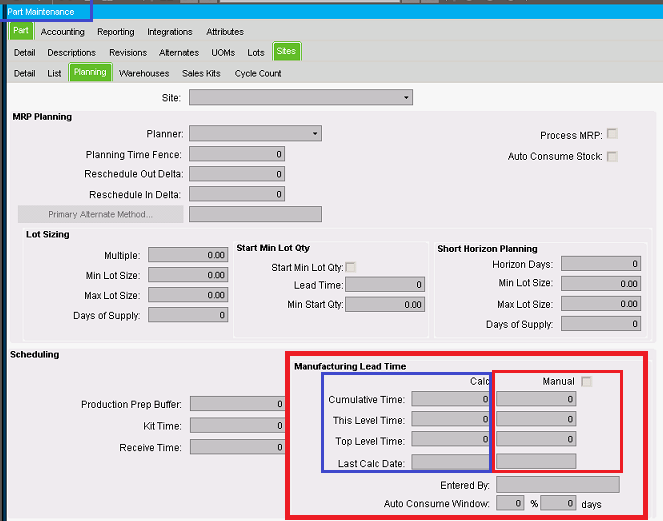

Not sure about firm date but FWIW…
I think lead times for manufactured parts can be “interesting” in Epicor.

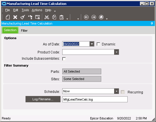

Why I like to start by running the Manufacturing Lead Time Calculation - to get an idea if the value returned reflects real life build times. If not, might be something wrong with my methods, rework required OR can manually override in job entry.
