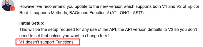

I don’t either … so dug a little into the EpicorRest thread to see how to do this. Unfortunately for this project, the base requirement for calling Functions from the client is V2 …
…this project is still using V1 :frowning:
So, while I super appreciate the Saturday morning assists/discovery here, I’ve been gated until we upgrade it to V2 apparently. @josecgomez (assuming this is still the case? Also, can V1 do this update via an UBAQ?)

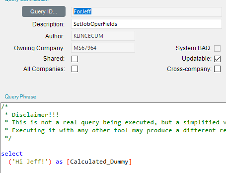

Well, then I’ll come back later and show you a UBAQ Example.
BAQ →
ForJeff.baq (24.2 KB)
Explanation →

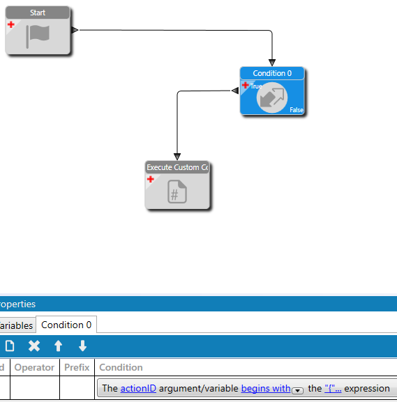

Advanced BPM Update checked.
No need to add a custom action, but add a base directive on custom action in the BPM designer.
Add condition that actionID begins with “{” (We are passing it Json)
True side goes to custom code that does this
UBAQ BPM → Base Custom Action

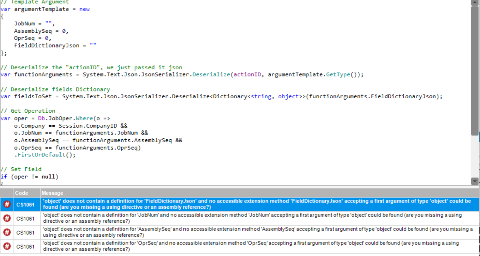

Made some progress… but getting some errors. Sent you a DM about how to add the Newtonsoft assembly (not sure how to do that as cloud hosted). I converted to native System.Text.Json to get past that but getting errors…
I attached my BAQ to that post. You can always copy it and rename then edit if needed.

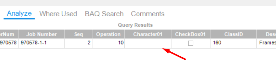

I’ve reproduced and re-ran my test. I see the updates happen, get an OK result, re-query Epicor using GetByID and see the values … however, when I run the query in the BAQ designer and via other REST API GetByIDs afterwards I see blank field values again – is this transactional? I can’t figure out why they don’t persist. Not getting any errors.
I definitely appreciate the help and don’t want to overstep – any other suggestions?

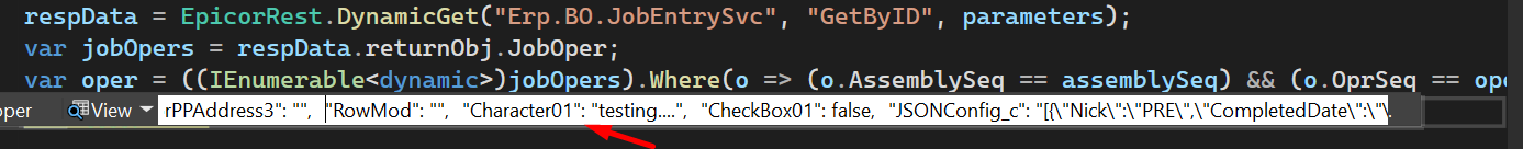

So right after the call to the UBAQ call completes (the code you provided), I run a new GetByID …
… you can see if I hover the return object from the GetByID that the UD values are present.
So I let that finish and the session ends. Then, outside of the REST API app, when I then query the BAQ directly in the Epicor client (filtering for the same JobNum), the values are blank… like it never happened; even tho we witnessed it.
…which is why I was asking if there was some sort of transactional revert that was happening or something. It’s like it never saved.
