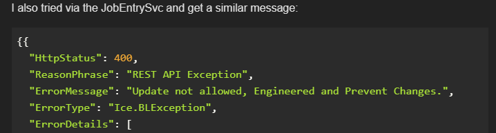

I also tried via the JobEntrySvc and get a similar message:
  "HttpStatus": 400,
  "ReasonPhrase": "REST API Exception",
  "ErrorMessage": "Update not allowed, Engineered and Prevent Changes.",
  "ErrorType": "Ice.BLException",
  "ErrorDetails": [
      "Message": "Update not allowed, Engineered and Prevent Changes.",
      "Type": "Error",
      "Table": "JobAsmbl",
      "Program": "Erp.Services.BO.JobEntry.dll",
      "Method": "valPreventChange",
      "ColumnNumber": 29,
      "LineNumber": 5316
  "CorrelationId": "1b733478-7cb3-4b16-b6f2-243ba3299c37"

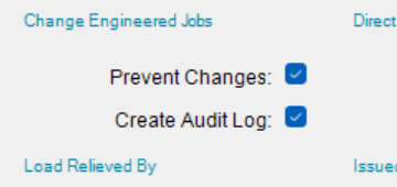

If it is engineered and you have prevent changes set you also need to give it a change reason or turn that off. We have it off and I can update Jobopers with no issues.

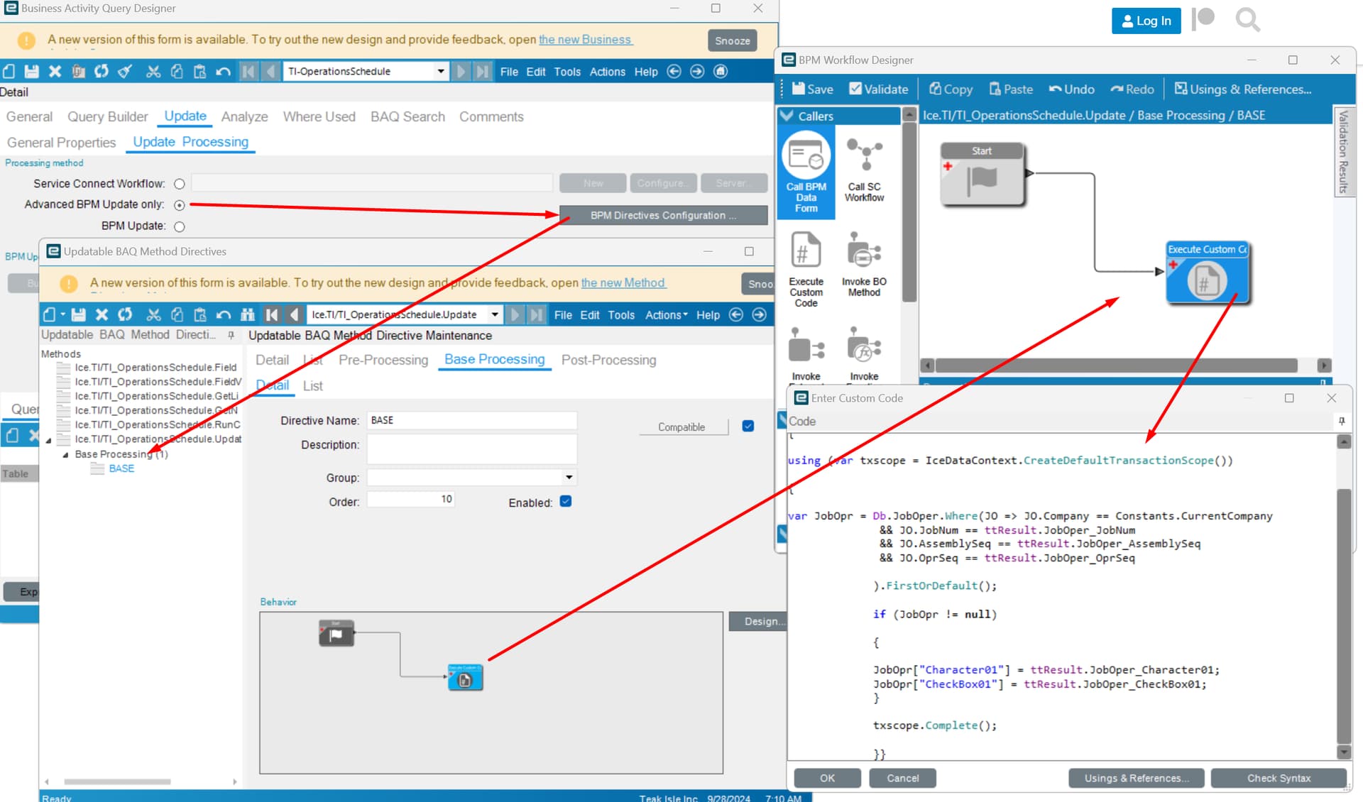

What BO is your BAQ using for update?
If it is JobEntry.UpdateExt → Are you using Erp.Tablesets.UpdExtJobEntryTableset ?
If so, you will need a row in JobAsmbl and JobHead I believe.
here is how the BAQ did it:

@mbilodeau … does your snippet via Functions work when Prevent Changes and Create Audit Log are enabled?

I did discover that the working UBAQ is actually calling a BPM (which is doing a very basic, find the oper and edit the fields, then Update) – which works.
I just can’t seem to get the REST API to do the same for our external interface w/o getting the “not allow/prevent changes” error.

Let’s see that.
Ask and ye’ shall receive!
