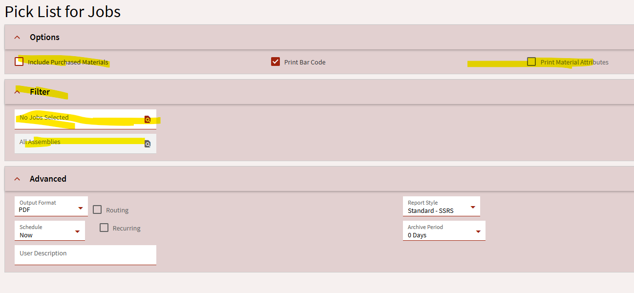

In the Job Pick List report, please clarify how jobs are being filtered and on what criteria. When reviewing the report, we observed that even closed jobs are appearing.
Could you please explain:
  • What conditions are used to include or exclude jobs in this report?
  • Whether job status fields such as Released, Completed, or Closed are considered in the filtering logic
  • The significance and usage of the JobHead.DueDate column in this report, and whether it is used as part of the job selection criteria or for informational purposes only
  • If there are any date-range or status-based parameters that affect which jobs are displayed

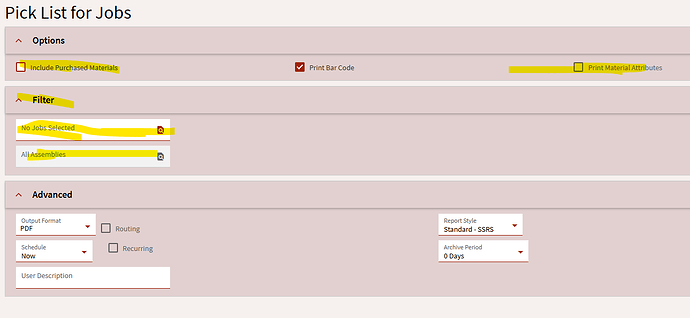

I think you only run a job pick list for a single job, or a known set of jobs. Not ide open. When you open the pick list report form, look at the filter section and enter or choose the jobs you want. The report doesn’t care anything about dates, or job status. It just gives you the pick list for the jobs you choose. This is one we never run without a filter.
