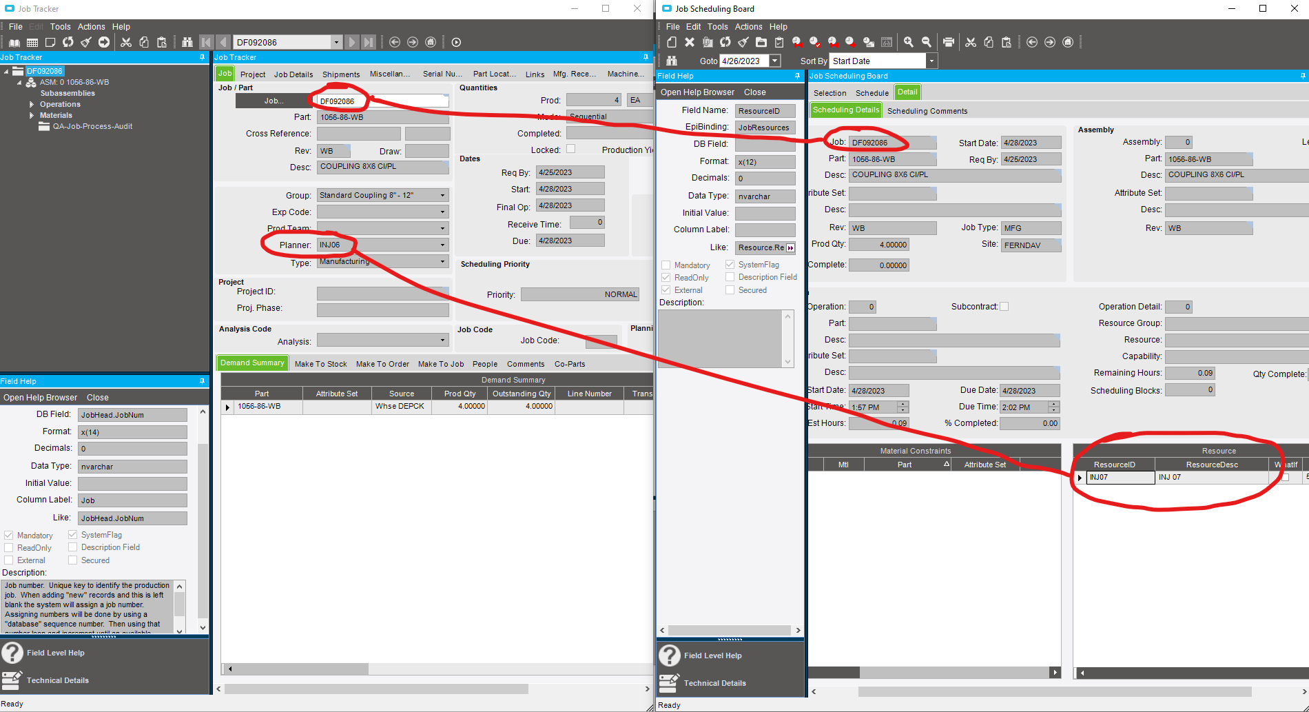

I’m trying to find the table & linkage so I can create a BAQ showing the resource a job is released to.
In the image below I have a job with a primary resource of machine 6, but it was released to machine 7.

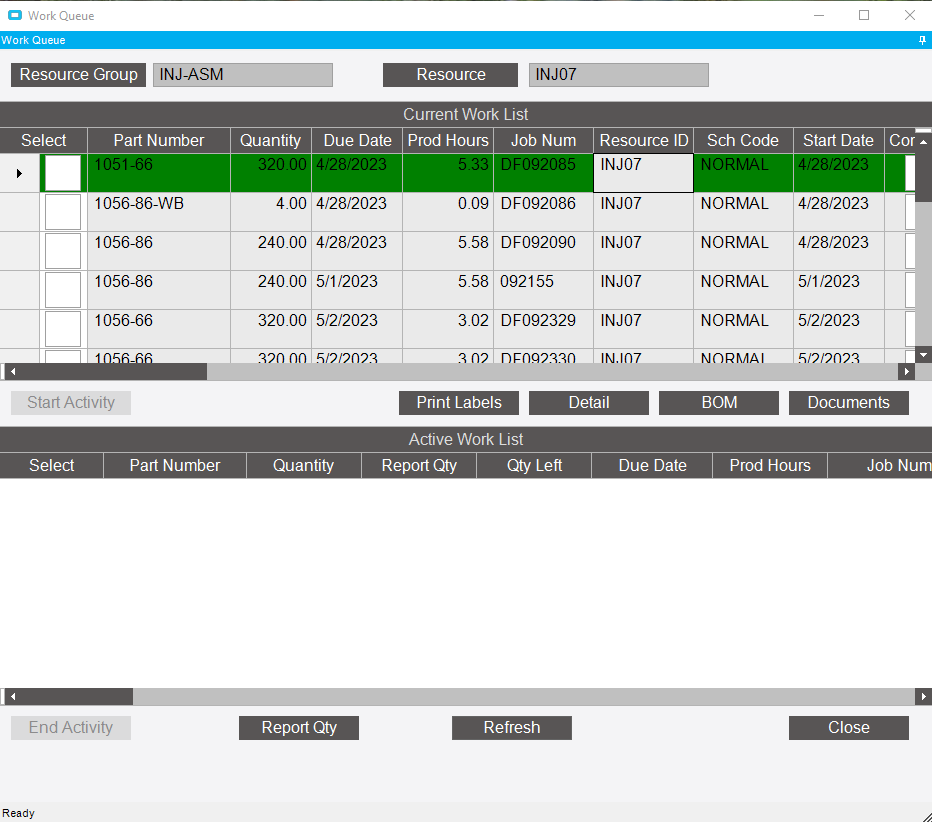

This job shows up in the work queue for machine 7. (2nd image, 2nd line)

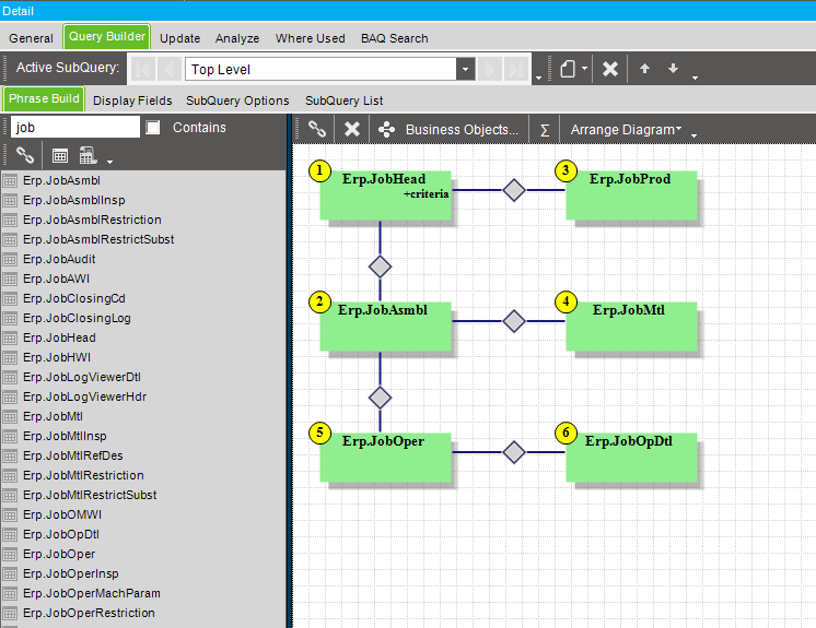

Below that are the tables I’ve been looking through but I only find references to machine 6.
Any thoughts or feedback would be appreciated, thank you!

In your first screenshot, the “planner” field is not the resource and has no impact on the schedule.
