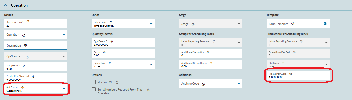

There are two Standard Format options that aren’t described in the Help but exist in the dropdown… Cycles/Minute and Cycles/Hour. If you select either of those options, a field opens up on the right of the window for Pieces per Cycle.
(this is in Engineering Workbench)
