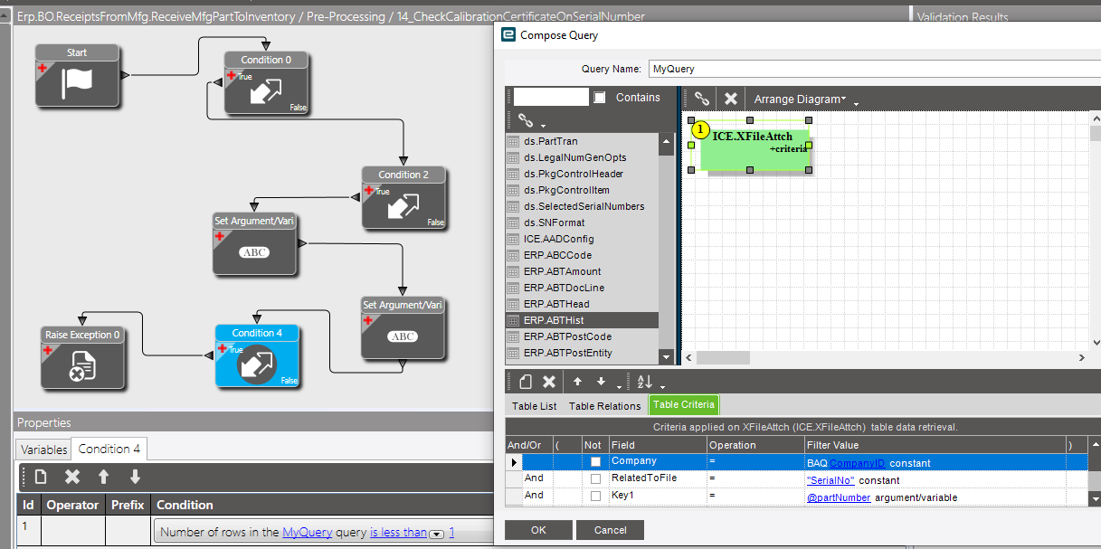

I need assistance with a BPM for “Job Receipt to Inventory.”

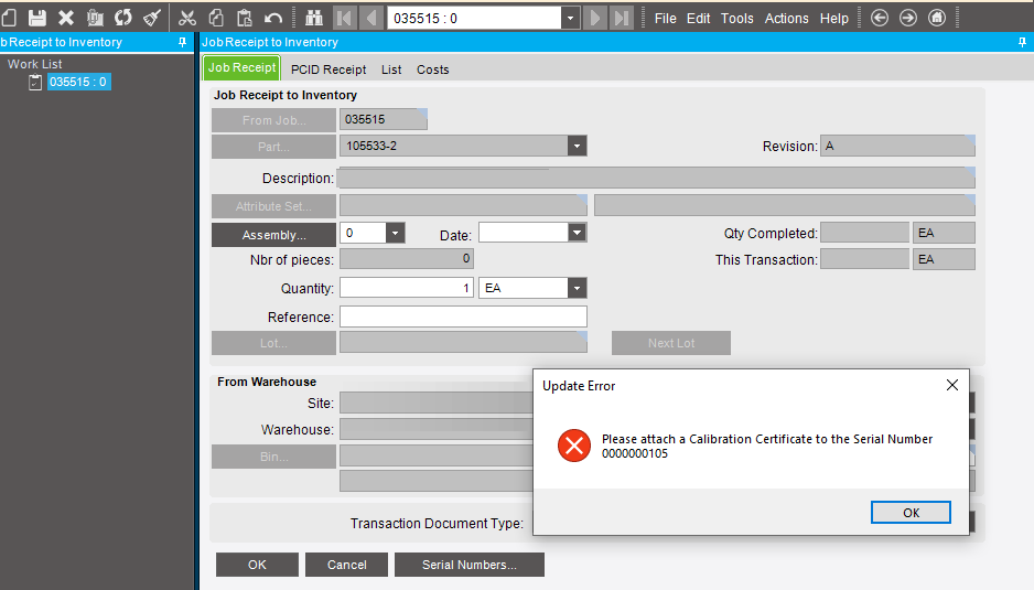

When a user clicks the “OK” button, they should receive an error message stating: “Please attach a document to the Serial Number.” I’ve included an image for reference.

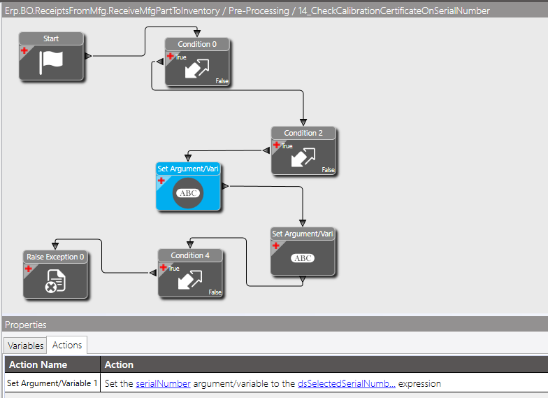

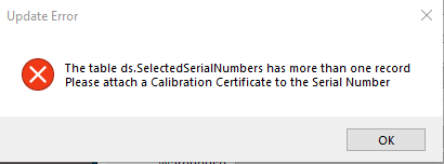

I was able to create a BPM that functions correctly for a single Serial Number. However, when there are multiple serial numbers, I encounter an error: “The table ds.SelectedSerialNumbers has more than one record.”
This issue arises because I assign ds.SelectedSerialNumbers.SerialNum to a single string variable. I’m unsure how to create a list and add numbers to it, and then implement a loop to check each selected serial number.
