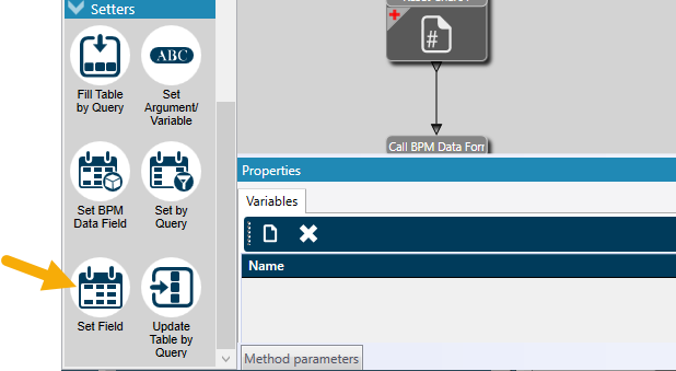

What business object / method directive did you use to do that? Was it C# code that did it or did you use the built-in set field thingy?

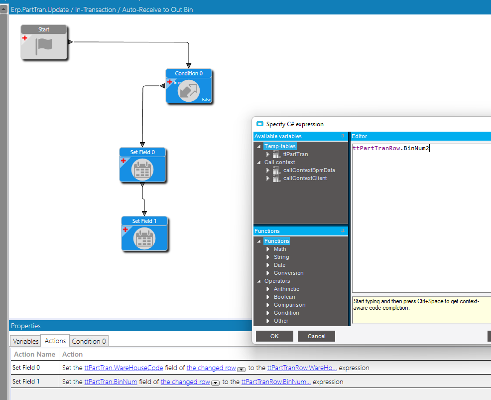

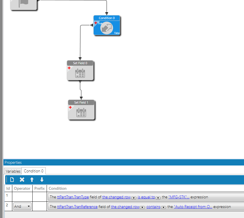

We ended up using an in-transaction data directive on PartTran looking for MFG-STK transactions with “Auto Receipt” in the reference field. For these transactions, we set the WarehouseCode and BinNum fields to WarehouseCode2 and BinNum2, respectively. We found that the “2” fields were correctly calculated to be the resource’s output warehouse and bin.
I was doing my test in labor update since I already had a routine to set auto receive on, but I like how @tsmith did this without setting and unsetting the part.
