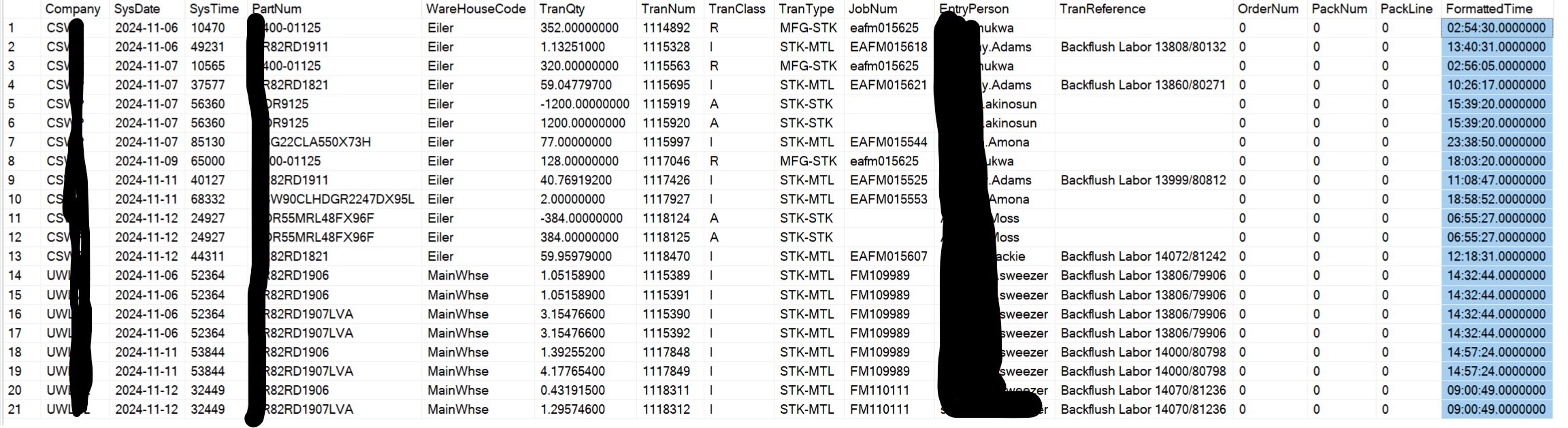

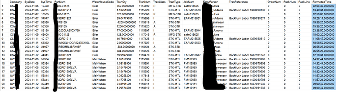

We see no obvious patterns. Here is my query (note it does not show the duplicates of the records, only records that have a duplicate). This is for the last several days - the issue goes back further, but seems to be intermittent.

@Chris_Conn These are backflush materials and the tranreference is the laborhedseq\labordtlseq that made the parttran.
Are they identical at the assemblyseq and mtlseq?
do you have any bpms or errors on labordtl?
The backflushed items shown are part of a phantom BOM with duplicates between the stages. It’s part of a coating package so the way that it was setup is based on the equipment it runs through by 10, 20, 30, etc. There can be the same base part number used in multiple steps.

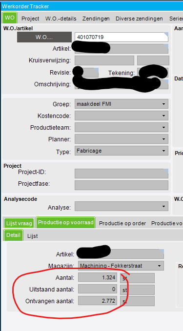

This is one example that happened today. The annoying fact that it’s booked to stock with the same cost value as the first transaction, while if you would do this by a normal transaction there would be no WIP costs left for the second transaction in this case.

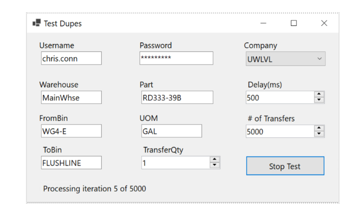

For any interested, I tried my darndest to break it.
I wrote an external exe that rapid fires thousands of STK-STK transactions via REST. I ran this on my PC as myself, and also ran it on a PC we know has had a duplication as a user we know has had a duplication.
After probably 20-30k transactions, I have not been able to reproduce a duplicate. :frowning:
Did you try any other trantypes? Like MFG-STK? Thanks for putting in the effort to trying to reproduce it. It is also possible that REST isn’t the issue? My theory is that when a call is made via rest and fails on the UI, it calls it again making it kick off twice. I am not sure, I am at a loss myself.
We have seen it affect multiple tran-types, I just focused on once so I didnt have to write more code, but I may have to.
I agree with you, I dont think the issue is server side\REST (at least directly).
