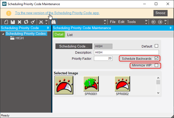

You can also check the schedule priority code. I’ve seen weird behavior with the backwards flag and especially with the minimize WIP flag:

Our Scheduling priority code is always set to normal, which has schedule backwards, and minimize wip checked.
