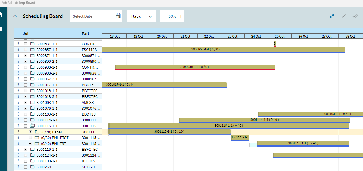

I have a job, that currently has 4 hours on one operation and 16 hours on another operation. Looking through all the settings, it looks like everything is set correctly. ON my job schedule board - look at Job 3001115-1-1, it looks to me like it is trying to block out more than the 4 hours and 16 hours for those operations. Any suggestions, where I should start to determine what is causing this issue. because if it is on this one, I am sure it is on many more

The 19th/20th of October are weekend days. The schedule board will extend the bars over the weekend days if the job is due to pick back up on Monday. Currently there is no way to alter this behavior - like not showing weekends or non-business days using the Calendar hierarchy.
