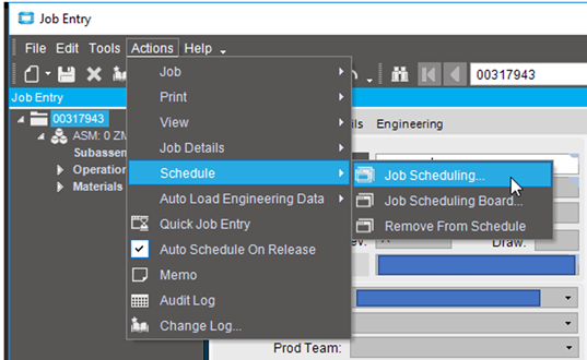

We have created a Customization on the the Job Entry - Actions - Schedule - Job Scheduling form:
But this seems a little different than our typical Form Customizations and we are not sure how to apply that Customization to the Job Scheduling form every time it is opened? We can see it and select it when we are in Developer mode but it does not open up automatically when developer mode is turned OFF.
Could someone explain how we can get the Job Scheduling Form to open with our Customization automatically?

Your calling program has to have the same Customizaton name and that program passes the customization name to all subsequent sub-programs. Even if there is no actual changes, create a customization in Job Entry and name it the same as your Scheduling customization.

I did get it working! Thank you SO MUCH for getting back to me so quickly and for the Wonderful Help!
