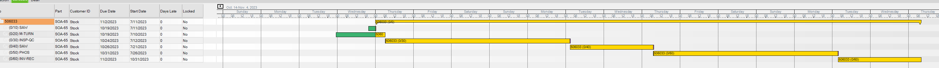

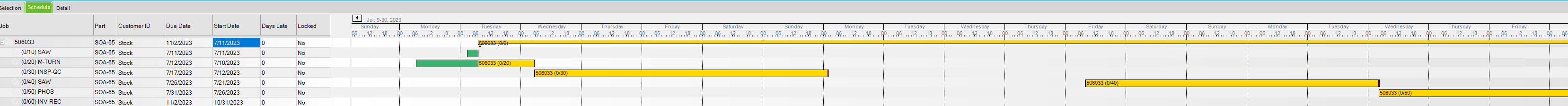

Hello,
I am trying to understand why job scheduling board leaves gaps between operations that are sequential? After i run calculate global schedule, a lot of the operations will not show to start after the previous operation is finished. I have set everything to infiniite scheduling. In job scheduling, if I click on the job and set it to “backward scheduling” the gaps disappear. Everything, I believe, is set to backward schedule already, so I dont understand why I have to manually click the job and do backward scheduling for the gaps to disappear. Any thoughts? thank you all.
It’s impossible to say by looking at just one job. What process did you use to schedule the job in the “before” image? What was the exact settings in the “after” image? Are you finite scheduling? Global scheduling? Is there another job taking up time on that resource?
Depending on the exact settings you use when you hit the schedule button, you can get a nice looking job individually, but creating a traffic jam when you look at the big picture.
I would look for the Minimize WIP setting - it’s supposed to eliminate the gaps. However, it could be because other jobs you are not looking at currently, are consuming shared resources. It’s possible that the global scheduling order, capability, priorities, etc. have all created the gap - which really isn’t a gap. Check the resource scheduling board and see if the gap exists still.
