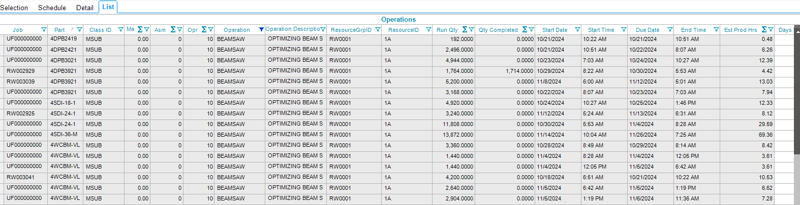

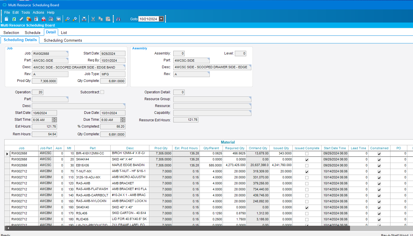

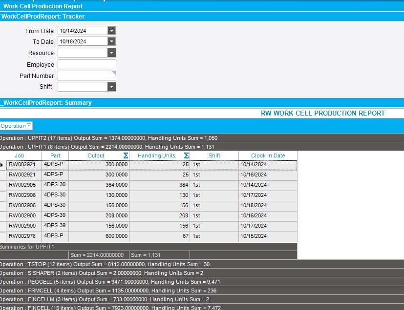

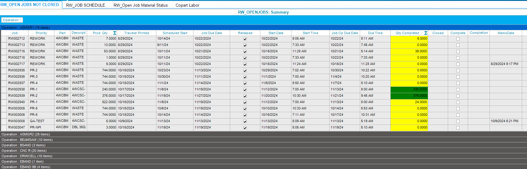

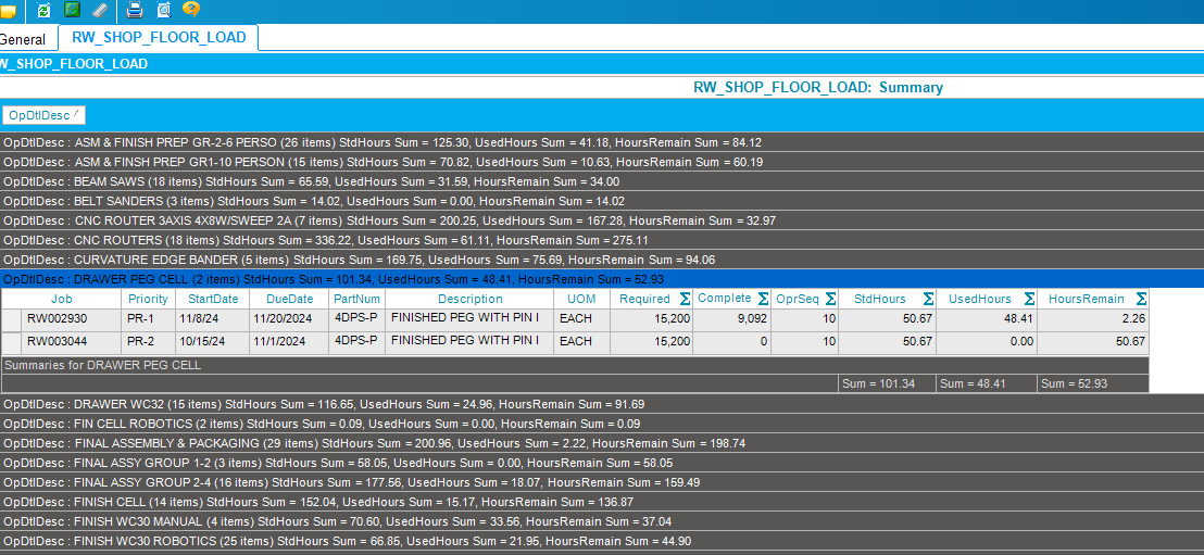

If you schedule in excel you can schedule in Epicor. Now I qualify that: first you must have a good foundation of accurate Methods built. I setup a brand new Wood plant for our company that we started from scratch. Built the building, installed equipment and then implemented Epicor from day one for production for the items that were given to them to mfg. with core Epicor scheduling. We made a few changes to the Multi scheduling board order of information to make it easy for the staff so they did not have to look at useless fields. We also constructed user defined dashboards to give them the real time information that they still were copying into excel. I told the staff that if they were doing any additional work in excel to give me the format and I would duplicated it in Epicor so they had real time accurate data. There is always resistance to keep people out of excel. But having them continue to use it is a waste of time and the information is no longer valid as soon as they complete it. The master planner creates a weekly schedule in Epicor and releases jobs to the floor and provides them with a list by work center of what they need to do.
Just a few screen shots of the dashboards our staff use
This is a view of our multi resource scheduling layout
in the list view they can filter by operation and sort by part
