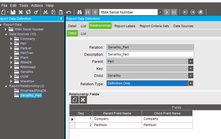

  1. I am having trouble bringing in the Serial Number of the part.
(Neither Definition Only or Output work)

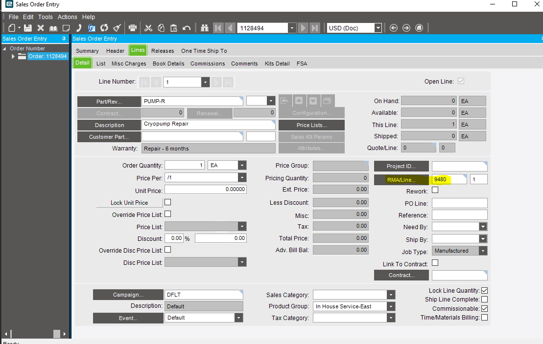

  1. I want to connect the RMA to the Job. I have an Order set up that is tied to the job with the RMA number in the line. But I am having trouble figuring out what table/field to bring in and attach. And if I am not successfully bringing in SerialNo, then I doubt I will be successful here either. There is a JobNum in RMADtl but it’s blank – when I try to add the Job Number to the line, it gives me a “Invalid Job Material Data” error when I try to save it.

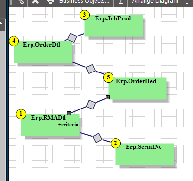

I think one portion of my issue is I am misunderstanding RMAs and Jobs. Because when I made a BAQ to test, even though the RMA was linked in the sales order, it didn’t show up in the BAQ under JobNum.

Is the sales order in question “make direct” (shipped from the job) or shipped from inventory? You can check on the order release tab, whether the “make direct” checkbox is checked or not
Thank you.
I believe they ship from inventory.
Sorry, I double checked, the release tab has Make Direct checked off.

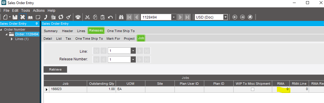

Interesting. I wouldn’t expect you to see any jobs on that job tab unless it was checked “Make Direct”.
If it’s shipped from inventory, that’s most likely why there isn’t a job number on the RMA.
But since you are seeing a job on that releases tab, you should be able to pull that field in to a BAQ to use (assuming it’s the right job)
That worked, thank you!
Good deal! I may have misunderstood your “checked off” comment, it does seem like that sales order is make direct. So I’m not sure why the RMA isn’t linked directly to the job. Could have been caused when the RMA was created, I’m not extremely familiar with that module.
