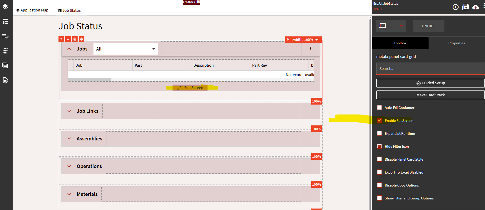

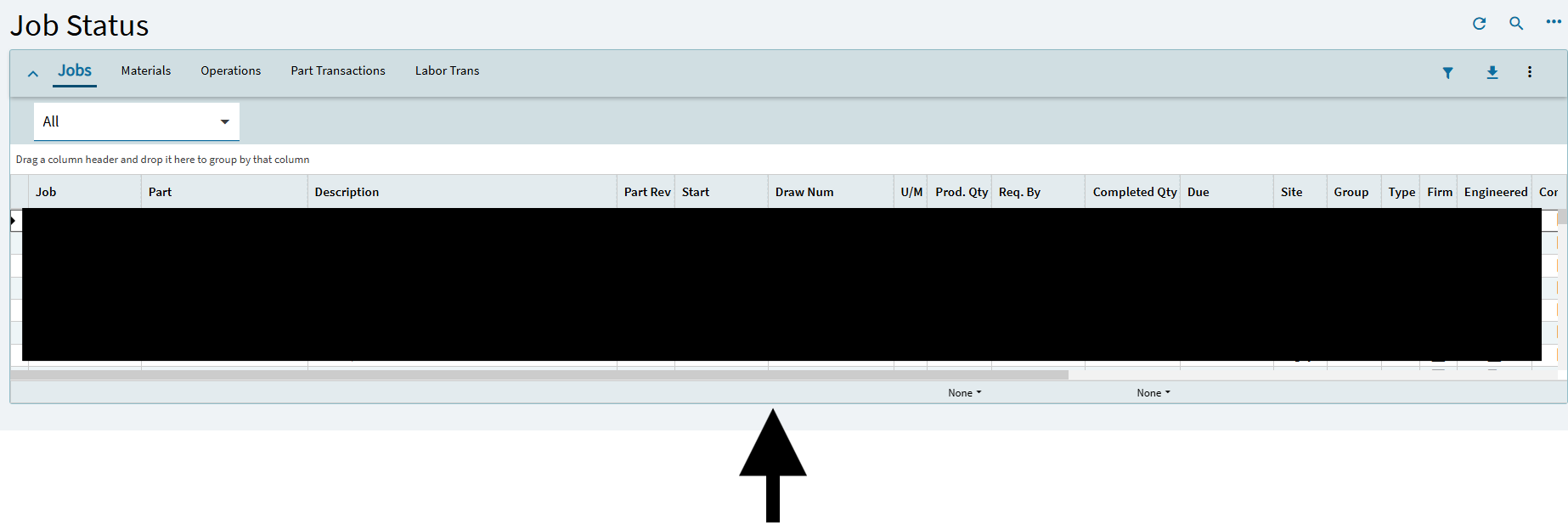

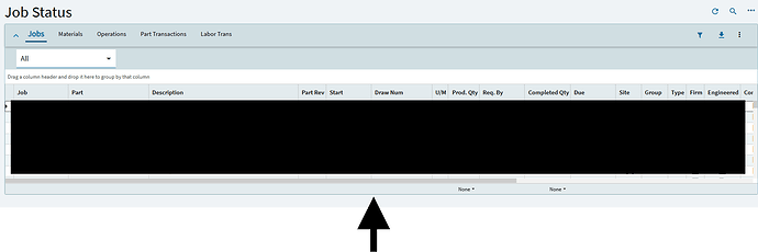

When retrieving results the I can scroll within the grid. I would like to expand the grid to see more results at one time
May have to modify in App Studio to increase the size of the grid space.
Modify in App Studio and turn on Full Screen:
Save as a layer. Then in Menu maintenance set that layer as the Kinetic Customization.
